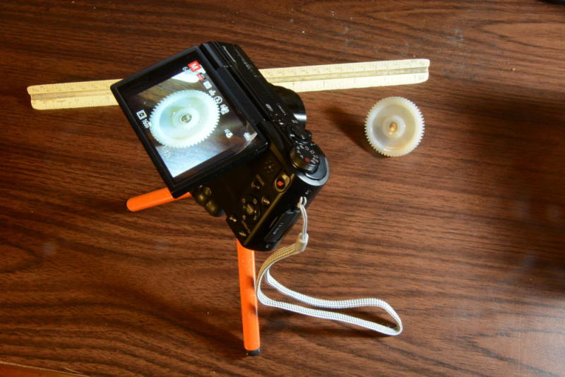

racookpe1978,
The Lumix camera that lives in my briefcase has just died, mostly from living in my briefcase. The new DMC-ZS45 I have just bought is very nice.
This shot was challenging with my DSLR. I used a tripod, f/20, and a one second exposure to get everything in focus.

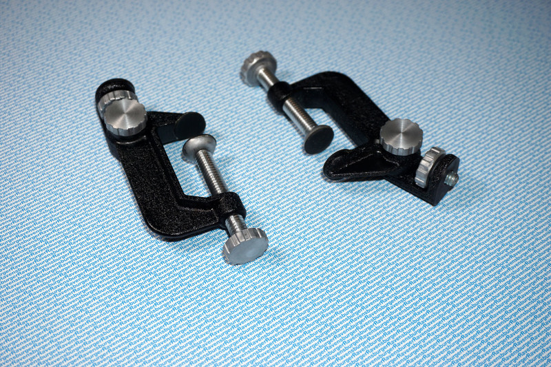

Speaking of C-clamps, it's handy to have a couple of specialized 'C-clamps' designed specifically for photography work, like the two that I've used over the years:
It may be hard to see, but the clamp-base of one of these is concave which makes it easier to mount your camera on a round object like a pipe or something.
