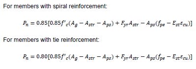

There is something not clear for me in the ACI 543.
Should I verify the following:
1.4D + 1.6L < Øc x Pa

In fact, for the last post, I was talking about reinforced concrete structural capacity of the pile.
The formula given for Pa seems too conservative for me, especially by adding the reduction factor Ø.
I have looked for the reference suggested by PEinc, and I have found the usual calcumlation of the nominal capacity of ACI 318.

Some of the difference seems to be that ACI 543 appears to work in terms of allowable service loads, while ACI 318 uses LRFD loads.

The problem is that ACI 543 is often referring to ACI 318. The use of table 4.3.3 is not clear for me.

Nut the structural capacity of reinforced concrete is not very clear, is it exactly the same as per ACI318, or there is other considerations to take into account ?
