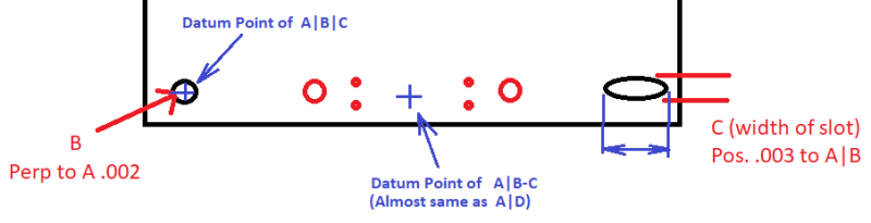

I'm making my head hurt because I think i'm making something harder than it needs to be.
I have a Circuit board that interfaces with a heatsink through two pins (part of the heatsink) with a hole (Datum B) and slot (Datum C defined by the width). There is a pattern of holes (two Ø.118 and 4 smaller ones) that are for a connector. This is all shown in picture 1.
Link
It is more important for the connector holes (really the Ø.118 ones) to be oriented to the A|B|C datum structure than it is to be located.
Picture 2 seems to make the most sense to me with respect to accomplishing my goals.
Link
Picture 3 is what i am more used to seeing, what I don't understand is how this controls the orientation relationship between B-C and D-E since Datum E is only positioned relative to A|D.
Link
Thoughts/Feelings?

What exactly you mean by "orientation to A|B|C"?
Because the only orientation I can see here is perpendicularity to A.

Meaning the planes defined by B and C are oriented to the planes defined by D and E. In other words right now if you draw a line between B and C and another line between D and E the angle between the lines is 0. In real life that won't be the case, right?

This way it still position.
Your picture 2 is the closest thing, although I am not sure if there is the need to introduce more datums into it.
If you could clarify relation between .118 and .018 holes, we could come up with more detailed solution
RE: Primary to Secondary Datum Structures
A connector first interfaces with the .118 holes which align it and then there are solder pins that fit into the smaller holes.
Assuming I understand the design intent correctly, I would say that your picture 2 is almost what you need. However, if the two .118 holes play equal role in locating and orienting the connector, I would probably make them pattern datum feature D (instead of separate holes D and E) and control the remaining four small holes with position to A primary and D secondary.

I can also see loose Position to A|B|C and tight position to A applied to both sizes of holes.
That will make them one "connector" pattern.
If "tilting" of "connector" to the board still critical, I would add single control to A|B-C to control how much holes can play up and down.
(All that provided all holes are located using basic dimensions)

B-C establishes "a line between B and C". "Just A|B|C" will override your "loose" A|B|C requirement.
To be honest, if all your holes are made "at once", from the same punching / drilling operation you probably don't need all that elaborate scheme.

I like the idea of having Datum D be represented by the two holes, I think I would do a composite tolerance there to control orientation tighter than location. My only hesitation with this method would be someone (vendor) making the part mis-interpreting it to be that Datum D is the one hole where the arrow goes....

If you choose the two holes pattern as datum feature D, the DRF for the 4 small holes will be A|D I/O A|D|E on your latest sketch.

Ah yes, forgot to delete the E off of the FCF on the Ø.018 holes. Thanks for all of the inputs
