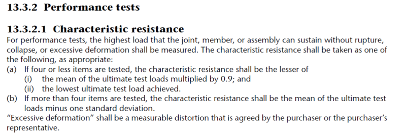

I'm helping a client come up with bending capacities for a new curtain wall system split vertical mullion. It's sketchy stuff so I'm recommending some testing. I'll have to come up with a testing program though and that's currently where I'm stuck. I would have thought that there would be a standard out there for testing structural things. You know, this many tests if you want to be at this confidence level. Does anybody know of such a standard? Or is time to bust out stats for engineers and go first principles on it? The blurb below comes from Canada's aluminum standard.

They are aluminum. Aluminum separated by a structural composite thermal break. And yeah, I will go with that if I can't find anything more definitive. There's also:
- ASTM E529 - Standard Guide for Conducting Flexural Tests on Beam and Girders for Building Construction. All they say is at least two tests and it depends how much confidence you want to have.
- ASTM E330 - Standard Test Method for Structural Performance of Exterior Window... I believe that this is the most common testing but I'm unclear if it's appropriate for product development or is meant only for project specific verification. This test would have the the mullions LTB braced by the glass. I'm not sure that's appropriate for this kind of investigation.

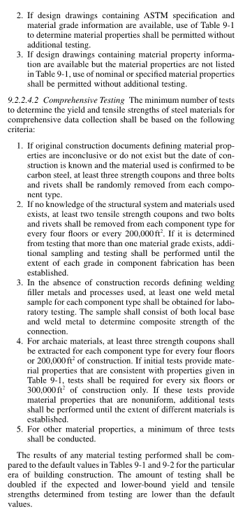

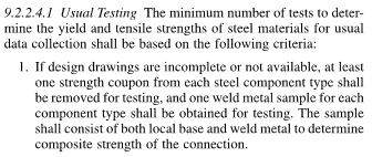

ASCE 41-13 has some guidance for material testing. Not component like it looks like you're trying to do, but may provide some guidance. Have copied screenshots for steel below since that's the one I've used recently and know where it is.
