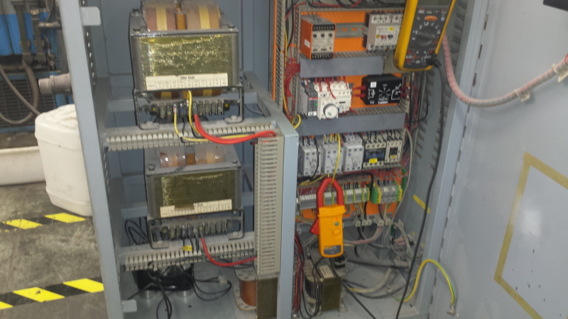

Our contactor supplies 380V off of two legs of three phase system to the primary of a
high voltage transformer. It is for Ultra violet light system on printing press. Previous
to me getting on seen this thing caught fire destroying several contactors and wiring in
cabinet with two other guys replacing components attempting to resurect it.
I put the unit in operation while monitoring current. Secondary output at moment of ocurance
was 10 amps, when contactor opens it starts welding melting contacts as seen in pictures.
Contactor in question is rated 400V @ 30A. I have posted schematic of circuit, contactor with
issue is K13 and capacitor bank is C2. The four capacitors are 30Uf and connected in Paralel with
accuall measurment of 117Uf.
What is funtion of capitors in this circuit and could they be causing the welding action of contacts?
If I were to connect them in Series for 7.5 Uf instead might that correct the problem?
Thank you, Chuck

A confusing circuit. It seems as if two independently controlled and protected transformers have the secondaries in parallel.
Is the damage on only one pole of the contactor?
I suspect that when the contactor opens and the transformer is disconnected, the transformer becomes an impedance in series with the high voltage developed by T2. The high voltage is arcing across the open contacts. The current is probably fairly small, but is continuous.
Bill

Hello Bill, Thanks for your reply. Yes two independently controlled transformers in parallel,
one (K12)operates to warm and maintain bulb temperture. K13 engages when press starts printing.
Yes damage on that pole only.
But wouldn't the primary side of transformer be isolated from secondary side? I don't
understand how this contactor would see the high voltage. An inductive kick perhaps?

I think Bill was right in the first post. If those are autotransformers then opening K13 will put the 1160V from T2 across the contact via the 1160V terminal of T2 to the 1160V terminal of T1, through the T1 winding, across the open K13 contact, through fuses F6 and F8, through K12 and to the R of the other tranformer.
So, putting 2 contacts in series might make it work, but you are still applying too much voltage to the contactor terminals assuming they are rated for 690V.

A picture of the control box below, I am going to monitor it after making new connections and
my Dept. big cheese is looking into properly rated contactors. I will post any further developements.
Thanks all, Chuck

RE: Some advice please, Contactor Meltdown
Basically an auto-transformer has one shared winding.
In this case the winding will be rated for 1160 Volts between R and 1160.
The winding is tapped at 220 Volts and at 240 Volts.
The R-220-240 Volt portion of the winding is often but not always a heavier gauge wire.
With the contactor open, there will be a direct connection through the winding from 1160 to R.
The transformer will now act as a choke in series with 1160 Volts fed from the other transformer.
The current will be limited by the impedance of the winding but even a small current will do a lot of damage if the arc is continuous.
Yes Lionel very possible, and just as important not rated for transformer switching (ac-6) I was not involved when that occurred and as I
understand it auto transformers like these are susceptible to short circuit damage.
Yes k13 open and k12 closed, many of our machines are purchased used and some come over from Europe so reassigning tap locations to
compensate for voltage is common around here. Forgot to add that the schematic is general to all similar machines manufactured by
Thiemer if you were to zoom in on picture of control box you could see the tap is actually on 400V input so 380 is within acceptable
10% allowance I think.
Chuck

However in the latest photo it appears that, wiring diagram to the contrary, the ballast is actually connected to the 380 Volt tap and the capacitors to the 400 Volt tap. That connection will put the same 20 Volts across the capacitors.
flexoprinting: You may want to try measuring the primary and secondary currents of both ballasts when both are energized.

219V across R and 220 on T2 xfmr- all terminals 1 Through 7 reading 219V terminals 8 through 10 @ 148V
219 across R and 220 on T1 xfmr- all terminals 1 Through 7 reading 219V terminals 8 through 10 @ 158V
219 across R and 220 on both xfmrs and jumper across both 1160 terminals I could see no current moving
or circulating between transformers.
I started the system up and allowed both transformers and bulb warm up.
T2 had 5.1 amps
T1 had 4.7 amps
Voltage across capacitor bank measurment taken at 420 and R = 412V on T1 and T2
Current draw on T1 caps = 19.4Ma
Current draw on T2 caps = 19.2Ma
Lionel, most of our German equipment has 50/60 Hz on data plate but not this one. It's 50Hz.
I assume this affects the frequeny of resonance, by how much? Really wish I had a HV probe
for my scope. Those portable Flukes are nice but spendy.
I added another picture first one not very clear, sorry about that.
Chuck

Lol, well I must have both shirt and hat on the way then. I performed another test after pulling my head
out of you know what.
With 380 L1 connected across transformers 1&2 on the 380 terminals.
L2 connected across terminals "R" for a 380v supply to both transformers.
Transformer 1 Transformer 2
----voltage reading---
1. 199.6----199.3
2. 217.1----217.2
3. 233.3----234.4
4. 249.7----250.2
5. 216.1----216.2
6. 1097----1099
7. 112.4----112.5
8.201.9----204.1
9.212.7----214.5
10. 223.3----225.2
All readings are very close to same, I think variation showing might
be due to other loads in building and time taken to move probes causing voltage to deviate slightly.
I did repeate the current circulation test (correctly this time) and seen some current flow.
R to R lead was @ 410Ma
380 to 380 was @ 400Ma
1160 to 1160 was @ 30Ma
We received our quote for ballast $5,800 .00 Yeow! Hopefully you are going to say they are good Bill.
Was talking to my Manager about it and he remembered saving pictures of OEM contactor that burned up in fire.
It's only rated for 600V, I also included the first time it let the gremlin loose.
wowwee! That was a nasty gremlin..
BTW Nice testing. You won't find closer matching than that in the real world.
What I think is happening is the contact opens and depending on where in the power
line cycle you get a huge arc as a lot of energy is stored in the magnetics or a not so big arc otherwise.
This causes the very classic "It worked for a year then did this!" result. Replacement and repair results
in some utterly random period before, "It happened again!"
This is the kind of thing often seen with wye-delta motor starters. Runs for a year then trips the breaker.
Runs for a month and trips the breaker, then runs for 2 years and trips the breaker. Lots of head scratching.
A snubber across the contact would limit the voltage available to arc, to something considerably lower AND
would provide someplace to dissipate the energy over a large surface area - the resistor in the snubber circuit.
Any arc that did occur would be shortened in period to something dissipatable by your contacts. What you have
now is a case of if the arc is a peak-energy arc then the contact metal gets so hot as to significantly
vaporize into the gap. It then participate in the arc plasma reducing its normal air-gap resistance down to something
shockingly low. In that state with more and more contact metal joining the party it becomes impossible for the
arc to ever extinguish because now the contact-space may have only 40~70Vac of interruption ability. This
continues until there is actually no further contact metal present to continue the arc. If you're lucky
you get what you just got. If you're not lucky you get what your latest picture depicts.
Even worse, the heavier duty the contactor is the worse the results because there is more contact metal available
to maintain the plasma. A heavy duty relay will give the latest picture results because you had ~2kW dissipating
in that space for maybe 20 seconds whereas the latest failure with perhaps a lesser contactor had exactly the
same power dissipation but ran out of metal sooner (10 seconds?), hence less damage.
Realize that when AC arc welding with a stick welder the substantial arc length is not much less than 690V contactors
can provide and that once the metal of the 'stick' is spewing into the arc the arc voltage drops to only 50~70Vac.
Picture an arc welding arc between your contacts. The final results would look just like what you have.
You need a snubber to limit the arc time and to suck up the stored inductance energy.
Sorry Keith, I beg to differ.
Remember that when only one contactor opens There is over 1000 volts across that one pole. The current is limited to a low value by the impedance of the ballast, but it does not take much current to do a lot of damage if the arc is not interrupted.
The original contactor had a 660 Volt rating. The replacement may only be rated for 400 Volts.
With 1160 Volts across a 400 Volt rated contactor you don't need inductive kick to maintain an arc.
That last picture looks like sustained arc damage.
I support your first excellent suggestion to connect two p[oles in series.
It could be that there are voltage fluctuations on the grid, and whenever the contactor is opened with the grid voltage on the high side of the tolerance, the 1160 Volt feed back is not interrupted and we have the sustained low current arc.
I find that oversized contactors have more of a cooling effect on the arc as a result of the greater mass of the contacts.
Bill
Hi Keith
Keith, would a snubber be a problem during normal operation since they are connected across phases? I understand those to divert high frequency signals or high voltage spikes and sense we need the resonant circuit and high voltage a Low pass or high pass filter would not work either way? Or are you thinking a four pole contactor w/nc terminals to bring it into circuit when contactor opens?
Chuck
