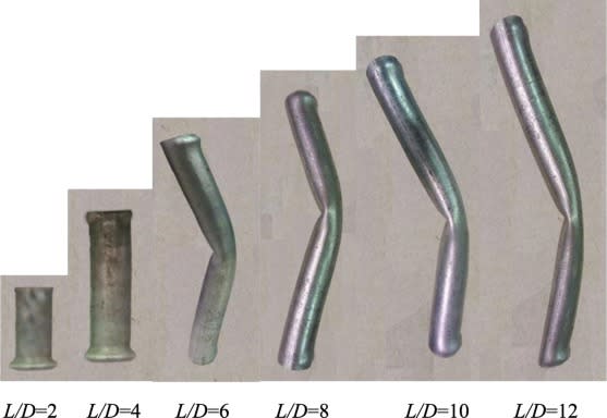

~And if you search for "elephants foot tube buckling", you find things like the pictures below.
If the conditions are right then a tube especially will fail in a compressive circular bulge or bulges. For a simple example think of a Coke can crushed under your foot. Get it right and it simply collapses vertically into a squashed flat, but wrinkled mass.
Buried pipelines and pipes heavily guided on occasion fail in compression like that, sometimes called a mash buckle or in columns they call it elephants foot.
If you have a solid rod e.g. inside a sleeve, but leave a certain short section able to expand sideways but not buckle, it will in the end simply yield sideways in a uniform "bulge"

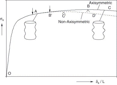

You can get pretty close to the correct answer, but you will never be exact. You can see why when you look at the images in LittleInches's post. No two failures were the same. When you get to Point A on his graph almost anything can happen, but that is discussing failure.
Elastic region is defined by the gradient of his graph. The gradient is a factor of how "pinned" the ends are.
If you are compressing the strut using pure axial loading (almost impossible), will the strut bend upwards, downwards, or compress as shown in L/D=2 and L/D=4.
