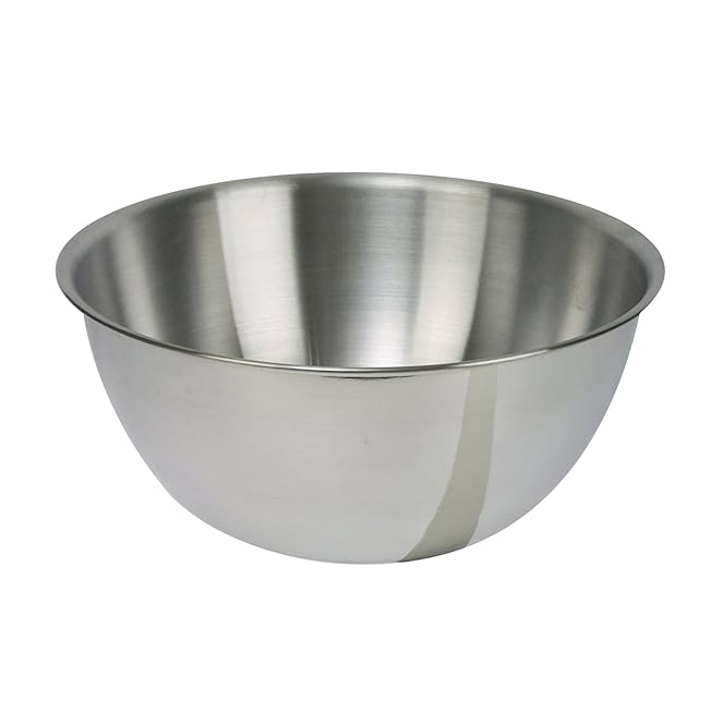

How to model sheet metal parts like this
and to be able to bend and unbend.I was trying with half feature and do mirror,but then I have problem with unbend.Couture flank and advanced flank are having problem with full circle SM parts.

This type of part is not manufactured using a 'bending' process, but rather either by deep drawing or by spin-forming on a rotating mandrel. In either case, due to the extreme deformation of the material, traditional unbending algorithms do not apply.

Thank you for answering,yes you are right this type of SM parts are produced with technology you mentioned,and not bending, but if the thickens of the walls are the same in stock and finished part -volumes are not changed ,how to unfold the part to find the stock size,in this example it's the circular plate.Is it possible to do this in NX?

If it's true that the thickness is unchanged, and you have a 3D model of the part, just measure the surface area (of one side) of the model and use that value to compute the radius of a circle with the same area and you'll be pretty close. Granted, this method doesn't use any NX functions, just a bit of grade-school math winky smile

I would strongly recommend upgrading to NX12. You can model the part in sheet metal using a circular tab and a secondary contour flange, the part will flatten using flat solid or flat pattern - enhanced to handle these conditions in NX12 (unbend will not work).
Another option is the flattening and forming tool added to modeling in NX11 (and improved in NX12) that will create a literal surface flatten (no distortion). Have a look here for a quick demo Flattening and Forming in NX12
Both methods produce a slightly different result and of course would be affected by material properties. There is another option - analyze formability - one step where you can define material properties.
On the part I created to experiment I got the following results:
Sheet Metal Flat Solid - ~50mm DIA
Modeling Flattening and Forming - 46.8mm DIA
Analyze One Step - 47.1 DIA
Select the method that best suits your process.

I didn't save the part however did a quick re-run and found the mathematical approach was extremely close to the flattening and forming result (without fixed elements)
