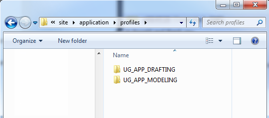

Hi
Is it possible to define a custom ribbon tab
So to behave like the standard nx home tab
I mean that the tab be shown when entering an application.
Thank you in advanced.

Hi Ronald and thank you.
I was read the PDF in your link and I don't
find any mentioned about home tab
To be shown when switching between applications

If you want to build your own home tab you just need to place it in the correct application folder to show it for that application.
Folders are in your site folder (installation directory or on server)
Ribbons and tool bars will only show for the corresponding application where they have been stored.

Hi Ronald
I did that in my custom folder
and that not work.
Thank you again.

Did you tell NX in the environment file that NX11Custom is your site directory?

Yes my UGII_USER_DIR is set to
nx11custom.

If I'm correct it should be UGII_SITE_DIR

UGII_SITE_DIR is locked by our administrator.
Thank you for your efforts.

As you are using the NX11Custom setup. Did you check if the "NX_CUSTOM_TOOL_BARS=${NX_CUSTOM_LIB}\ToolBars\" variable is pointing to the correct location? (as described in the readme file)

Hi Ronald
I'm so sorry. About the confusion.
The nx11custom is just an empty folder
That I filling it manually with my
Custom stufts.
And I think you confused with other setup.
Sorry for the confusing
