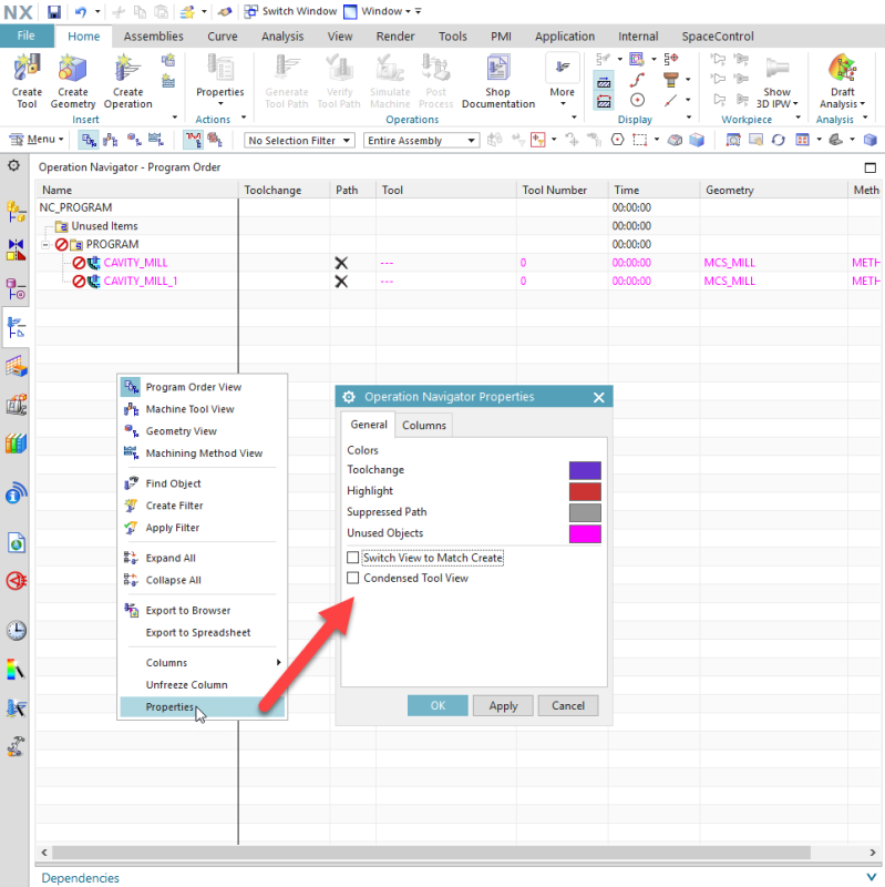

Okay, I am a seasoned programmer and I seem to recall running into this a long time ago but I cannot recall why operations text is green in the Operation Navigator. The text in every column is green rather than black. Why? I looked in the docs but couldn't find anything about it.

I've never noticed it untl reading your post, but I think it's the unused objects setting (see image, I changed that to pink).

Soon after I created the thread I discovered it was indeed because of being in the unused group but thank you for your reply! I rely heavily on templates and rarely ever use the unused group so I think I may have accidentally dragged it there.
