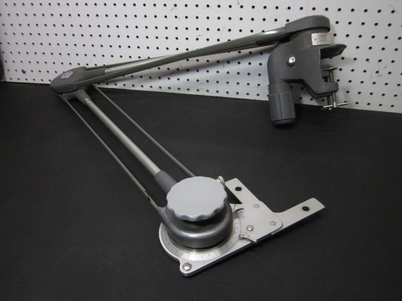

Oh, and I almost forgot, up on a shelf in the garage I have an old Bruning Drafting machine (the image below is identical to mine), complete with scales, which I bought back in the mid-70's for $10 when our office replaced the old parallel 'pulley & band' drafting machines with the newer horizontal/vertical track-type machines (a couple years later we started to buy CAD/CAM systems). They also got us new drafting stools and I bought my old one for $5 and still use it at my workbench in the garage.

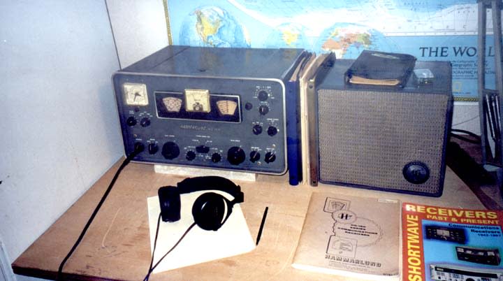

I also have a drafting table in the garage, but it's currently being used as a radio stand for another antique, a Hammarlund HQ-180AC general coverage radio receiver, vintage 1965, as seen below:
