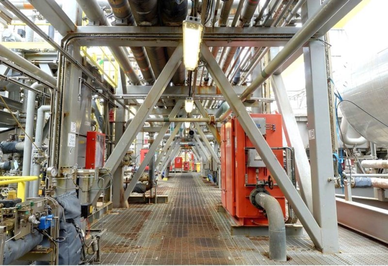

I have a 250x250x10 square hollow section (SHS) horizontal beam where the entire top wall has corroded over a length of approx. 200 / 300mm, e.g. the cross section now resembles a U rather than a square.
I am looking at potential repair options. The beam is on an offshore oil platform, so welding is not really a solution the Client wants.
Further, the existing loads in the beam are 'unknown' at this stage (I am trying to get hold of the original design report, but it's proving difficult). I therefore want to try and approach this to make the repair full strength, or "as strong as the original section". If this is impractical, I will need to do an analysis of the structure (which will be time consuming) just to find the loads in this beam, in order to apply a (potentially more practical) "non full strength" repair. By the end of the analysis, I of course might discover I need it to be full strength anyway!
So, I see my possible repair options as:
1) Welding a new cover plate to replace the top wall (least preferred by Client due to Offshore restrictions on 'hot work')
2) Bolting a new cover plate to replace the top wall (not preferred as introducing new holes / corrosion paths into the box, reducing section strength at bolt holes, hard to maintain seal to prevent corrosion inside the SHS, likely many bolts required to develop full strength)
3) Bonding a cover plate to the top wall (e.g. Belzona 1111 Super Metal as the bonding agent) (not preferred as no data on Belzona shear strength or fatigue life)
4) A composite wrap (e.g. FurmaWrap or Belzona SuperWrap) (Client has basically said No to this option right off the bat)
5) Any other options you kind ladies and gents may know?
Thanks.

Thanks for the input everyone. Picture attached. The corroded section is under the black pipe to the left of the nearest light. There is insulation around the pipe (which can be removed) so access it not as tight as it first looks.
My current thoughts are to re-support all of the pipe work on a new beam which is underslung from the two RHS's sections on the left and right of the picture - this gets the pipe supports out of the way. I'm not too concerned about overall changes to the load paths in terms of global structure as it is still pretty close to the original design. Obviously I will need to check the RHS members for the increased loads, but I do not suspect this will be a problem. Note the lower pipe on the right is plenty clear of this option.
JAE's channel splice will need to account for the braces, but it just means a longer section of channel than that required to just bridge the corroded area. There shouldn't be a huge amount of moment anyways considering the braces, but without actual loads I am tempted to design the repair for the full section capacity (very easy to justify considering unknown loads). Yes, it will be overkill...
Tmoose - there have been some wall thickness tests carried out and it appears only the top wall is affected. I think the pipe support shoe has been been rubbing across the top of the SHS which has a) removed the paint, and b) trapped water etc. leading to accelerated corrosion. On my list of things to do is to get more points measured around the walls to check for other areas where wall thickness has been lost. Currently it looks as thought this will not be too much of a concern.
jgKRI - yes, I would be much more comfortable knowing what is going on. You are right JAE's solution doesn't pick up any axial loads, but I had thought about blind bolting his channels at a few locations to transfer any axial loads through the channels, or perhaps running the channels full length and having them connect to the posts. I'm keen to avoid trying to provide a full moment connection at the posts (capable of resisting the full section strength) as it will be hard to achieve. JAE's 'splice' to carry the moment over the corroded section, with some additional axial capacity should be easier to achieve.
SAIL3 - yes, sealing still to be addressed, however it would be much easier to achieve if the seal also does not need to be load bearing.

It looks to me like the repair will need to be repeated for each of the "bents" in the picture with the same pipe support detail = at least 3 or 4 more times .
RE: Repair of Square Hollow Sections
Tmoose - not sure what you mean by "bents", however we have had the entire pipe rack surveyed across the entire FPSO and there is only this one location which is an issue. All other members / supports have been inspected and are OK.

If you moved 18-24" in the direction out of your picture, away from the fixed frame, and placed a beam parallel to the fixed frame, and 4-5" below the piping, and as long as the beam member on the fixed frame. This temp beam would fit laterally btwn. the two 4x10 (or whatever) RHS members which are pointing out of the photo, btwn. two bents. Atop this temp. beam, band sawn oak saddles, wood blocks and wedges fit up under the various pipes to snug the pipes up, on the temp. beam. Work from the middle out in both directions. Then the temp. beam can be jacked up 4, 5-6" to lift the pipes and their saddles up off the bent in question. Shore the temp. beam for the duration of the work, from below and to the 4x10 RHS members.
I would break form a piece of .5" stl. pl., 250mm + wide on the inside, with turned down legs about 5" long to just fit over the existing horiz. 250x250 member, and only a couple inches short of the existing member length. Pre-drill bolt holes in the legs for one of several different blind bolting systems. These holes will also be a template for drilling the existing SHS webs, in place. This downward facing channel shape should be able to be slid into place if the pipes are lifted about 4". Then the pipes can be set back down for the drilling and the bolting to act as part of the hold down needed for this operation, but maybe not. You now have a system which adds a new top flange and bolting can be designed for whatever shear flow is needed to make this a true built-up member. Maybe you shouldn’t set the pipes down all the way, so as to keep the horiz. SHS unloaded until the bolting is completed. Gotta think on this a little more. The worst loading on these members may be when they act as lateral loaded frames, those are some pretty sizable braces, if their size really indicates their loading possibilities.

dhengr - yes, the root cause is something I plan to address in the 'final solution'. I am thinking along the same lines as you I think. I intend to add a new beam slung below the two RHS beams which come 'out of' the picture at the left and right hand sides. This could be temporary, however I think I will just make it permanent (it means less work overall offshore as they don't need to double handle it). I will design this beam to suit. On top of this beam (which I picture probably being a UB or UC section) I will get 'wear plates' (say 20mm thk) welded on during fabrication at each pipe support location. I will then add replacement pipe shoes / supports on top of the wear plates with some packers to make up to the current elevation of the pipework (e.g. no raising of the pipe work required). I might even add some PTFE type pad to prevent steel on steel rubbing, and break down of the coatings. I need to mull that over some more though.
Once that's done, I'll get the pipe shoes / supports on the corroded SHS cut off and removed, leaving the top wall of the SHS clear.
This will give enough clear space between the top of the SHS and the remnants of the old pipe shoes to add any of the strengthening options touted so far, and also frees up space to clean up the corroded section, dry it out, seal etc. This also means (assuming the strengthening fits in the space) there will be no need to adjust pipe elevations or add 'high spots'.
Your idea of a channel shape along the entire top flange is good, and will definitely make getting the required shear strength to take the moment through from the SHS into the channel easier. I think I would need to torque the bolts in this case though to get friction between the channel toes and the SHS walls, as the slip in the clearance holes before the bolts go into bearing may be too much (e.g. the channel would only be effective once the slip was taken up by loading and deflecting the ex. SHS). I will think on that some more. Torquing might well be OK anyways, I can easily check whether the SHS top wall buckles under the preload.
Yes, I also expect the lateral loading in the whole frame will be critical for the member design, I don't think the vertical load from the pipes will amount to much of the total. The braces are probably way over designed, but it's hard to know without getting the existing report, or crunching the numbers myself.
I think I would then leave it like this - all pipe supports relocated onto the new beam, and the existing SHS made good via whatever option is picked. Sure, there is a small change in the load path (e.g. support loads are now carried via the RHS) but my instinct says this should be (still need to calc it) a small overall increase to stresses in the RHS, and fairly easily justified.
