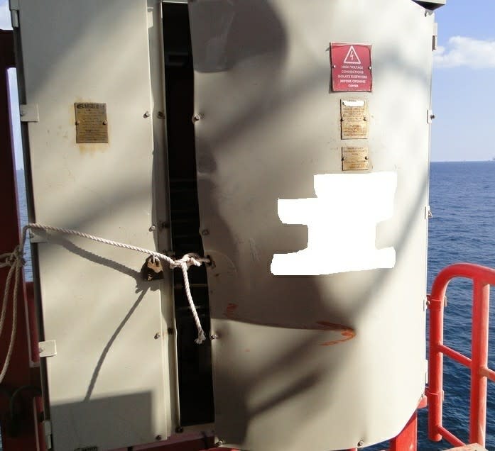

The system:
This is at one of the oil producing offshore Well Head Towers (WHT). The electrical power to this WHT is supplied through 6.6kV submarine cable. The cable is terminated in an Ex 'e' junction box installed above the boat landing level. The system is energized about an year ago.
This is an unmanned tower. The junction box has hinged door, bolted while fully closed.
Incident:
Recently, during the visit to the WHT the junction box door was found ruptured and left hanging on the junction box (JB). However there is no charred marks inside the JB. The connections are found intact.
The 6.6kV connection is not covered with insulation boot. Now there is an argument that there could be some ionization inside the box due to the exposed 6.6kV terminal thus releasing the hydrogen. The accumulated hydrogen must have resulted in an explosion, thus rupturing the JB door.
There is another school of thought which argues that there could be some chemical reaction inside the cable insulation thus generating the hydrogen and which must have reached and accumulated in the JB cavity.
Now the question:
Does anyone has such experience of hydrogen gas generation and accumulation in the cavities in the oil producing towers?
If you can share your experience, it would be very helpful to me.

In fact I am trying to solve the mystery. If you are familiar with the oil and gas facilities, you will appreciate the gravity of the such incidents. It has a large hidden consequences.
The WHT is unmanned. When the mechanical maintenance crew visited the site, they have noticed that the cover is hanging in one bolt. The 6.6kV live terminal is exposed to the hazardous environment.
The JB has no visible mark of burns, hence people suspect that it h=could be the explosion of trapped hydrogen gas inside the JB.
For your argument of chlorine release:
The salt would help the solution to conduct. During the electrolysis process, I understand that the Oxygen and Hydrogen will be released. Not the chlorine.
Now please throw some light.

Any chance of photos?

I thank for the overwhelming responses.
The JB is IP66, manufactured as per IEC. The installation is in the tropical region offshore where the relative humidity is almost 99%.
I have attached a typical photo for the understanding.
There is not a considerable bulges on the sides and back.
There is a breather for the JB.
It is stainless steel with corrosion-proof paining.
David,
The cable size is 3 core 240 sq mm and the load current is about 20A. So there is no question of the termination/connection heating up in this case. The cable connection is still intact and no charred mark. Only the door got ruptured.

That box is EX e, you can't be serious
RE: Rupturing of 6.6kV Power Junction Box installed at an offshore oil production Well Head Tower
roydm,
Why?
I would bet on gas evolution or propagation through the cable.
I doubt that there was a real explosion (with combustibles) but rather 'just' over pressure event.
There is obviously no vent on this, or not a functional one.
Venting these is very problematic. Every day as the box heats the air expands and vents. At night it cools and sucks in humid, salty air which then condenses inside the box. The next day the process repeats. I have seen the insides of 'sealed' boxes heavily corroded by this process.
And then with corrosion more heat is generated, and steam, and then all sorts of things go wrong.

Hi Krisys,
I know of at least two other instances similar to yours on offshore facilities that were attributed to hydrogen. In one of them gas detection was installed post event & confirmed development of flammable gas in the JB. Some attempts were made to confirm which gas but I think inconclusive (It could be argued that that in itself suggests hydrogen, which escapes on the way to the lab).
Hydrogen from corrosion of conductor or (particularly) galvanized armour is a recognised problem for subsea cables and umbilicals (also fibre optics where it darkens the fibre). Permeation of hydrogen dissolved in the seawater is also discussed - I had thought only applicable to deep water but have seen recent references for shallow. Hydrogen-producing bacteria sometimes occur subsea. Hydrogen is very small (especially if dissociated to ions) as those who keep H2 inside generator stators, or specify pressure instruments exposed to process hydrogen, will confirm.
http://www.oedigital.com/subsea/item/269-umbilical...
http://ripr.org/post/case-closed-hydrogen-gas-comb...
http://www.jdrcables.com/case-studies/van-gogh-pro...
marks: green goo is degraded plasticiser. It is not explosive.
