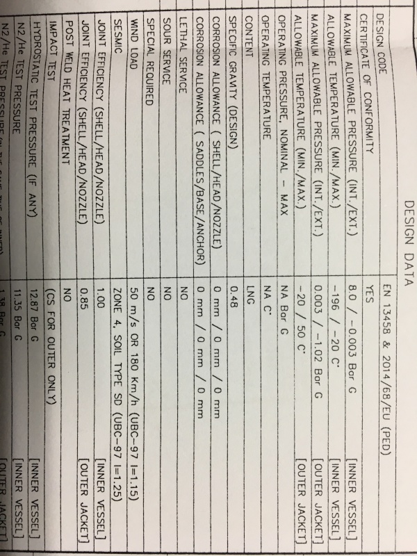

I have seen one of the datasheet for cryogenic vessel which specifying the vessel shall be designed for Allowable temperatures of -196 Deg C as the minimum and -20 deg C as the maximum.
I beleive that this implies the vessel can withstand with a lowest temperatue of -196 deg.C and maximum temperature of -20 deg.C.. please suggest me whether my understanding is correct or not If my understanding is correct , then it means that the vessel can not withstand a temperature which is higher than -20 Deg.C.. then how we can do the fabrication and keeping of the vessel before commissioning at ambient temperatures which is for sure higher than this -29 Deg C.
once we are filling the vessel with cryogen the vessel temp will reduces to very low values say -196 Deg C.. but still doest it make sense to consider the maximum allowable temperature as -20 deg c for the design ??.. please clarify my doubt ..

I would like to provide more details regarding the design conditions that i was talking about.
please see the attached image herewith.
RE: Cryogenic Vessel Design Specification
It would be the allowable temperature during normal operation, i.e. when filled and used for storage. Unless it is being installed in the arctic, it is going to sitting above that when not filled due to ambient conditions...
You have a jacketed vessel, the inner vessel contains the cryogen while gap between the vessel and jacket is insulated and a vacuum is pulled to minimise heat ingress.

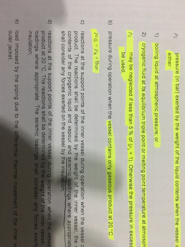

Additionally, part of EN 13458 is to calculate the maximum allowable working pressure when the inner vessel is filled with warm gas (20 degC). You can always ask for that value from the supplier, but I suspect they have just put the larger of the 2 (comparing with cooled down and storing cryogenic liquid).

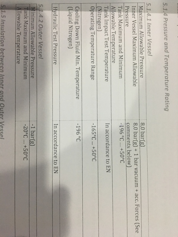

Thank you so much for reminding me the point that i missed .As per EN 13458-2 the inner vessel must be designed considering various loads,in which MAP with vessel contains gaseous products at 20 Deg C is also required . And more over I find out the client specification for the design. Client datasheet specified -196 to +50 deg C as the min and max allowable temperatures.
please see the attached images for EN code mentioning and Client Spec Respectively.
I hope that the design missed this points somehow.
