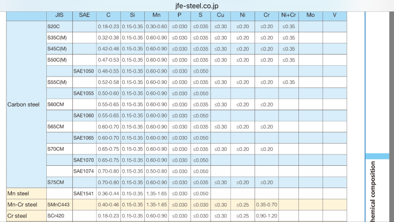

Take a look here
http://www.jfe-steel.co.jp/en/products/sheets/cata...
Double check the stated specification, there is an SCM, the SCM appears to be a designation for low alloy steel. There is also S-CM which is cold rolled special steel sheet.

Thanks for the link, I would agree that the SCM and SNCM would be Alloy steels for machine structural use. These parts are transmission parts so that makes sense. Still did not see a SCM20 designation, there was a SCM420 but that had Cr & Mo in it.
The search continues, We have a list of items to ask the customer I will have to put this on that list at this time.

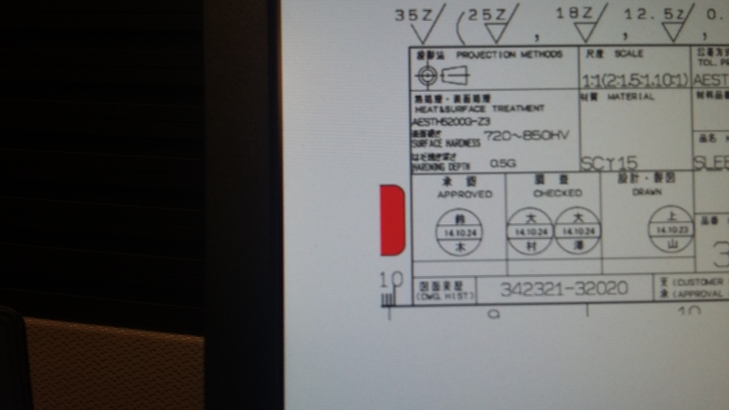

Have another print that has SCY15. So this is Steel, Carbon=.15 & ?
This gets carburized to a depth of .5min after grinding, case hardness is 720-850HV probably a very old Japanese spec also.
RE: Material spec. SCM 20??
Olds468 could you post a picture of that print where say: SCY15 ?

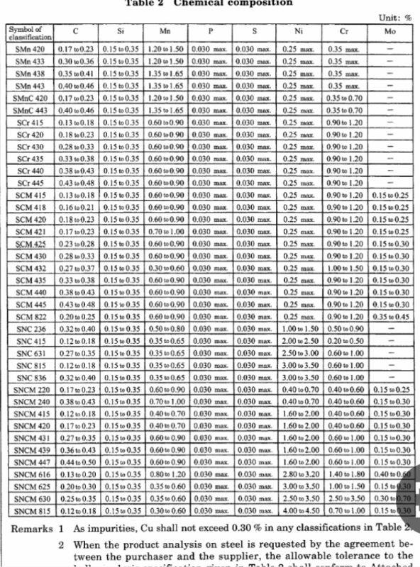

It’s SCr15 = Cr steel whit C~0.15% and Cr~1% mainly (see Cr-Steel in attached image)
Thanks MarriolaV this will help

MarriolaV,
This material would be like a SCr415 ?? if there was one on the chart.
