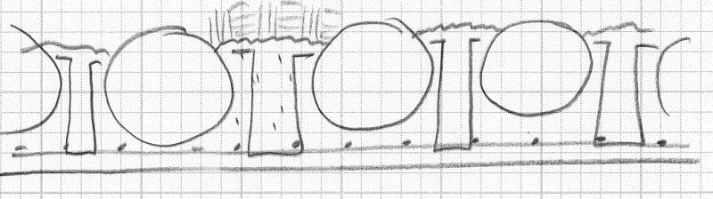

On a project I did some years ago we used 24" diameter concrete cast soldier piers spaced at about 4 ft. o.c.
This left a bit of a gap between the piers - the earth between the piers was excavated back a bit such that a reinforced concrete wall cladding was placed in front of the piers.
The concrete between the piers was tied into the interior wall reinforcing with hooked "U" bars which tied in the wall face with a slight bulge of concrete between and just a bit behind the piers.
You can do all this infill concrete with shotcrete as well.
One thing we did (which isn't shown in the very rough sketch below) is that we also placed drainboard with filter fabric between the earth and concrete between the piers and drained it
down to the bottom of the wall and under the wall to sumps. Not necessarily needed but simply an added assurance that water had a path to go.

I like the way you were able to "key" your concrete wall in with the piles. We are probably not going to be able to have that option as spacing the piles that far apart will result in too much moment in the piles during excavation, resulting in a pretty non-economical pile. I have included our detail of the pile wall and shot-crete below. We did a similar wall drain as you described, to help give the water a path. More of a feel good factor than something we completely relied on for the wall design. We still designed the soldier piles for the saturated soil lateral pressures.

I would think that your piers are too close together to create any real positive soil pressure against your shotcrete.
Perhaps using 62.4 psf/ft pure water pressure on the shotcrete to determine the amount/strength of ties into the piers.
And that pressure would be only on the small width between piers I'd think - not the full width - so factored down a bit due to that effect.
Also look at a uniform 5 psf lateral on the interior face - seismic, wind pressure type loading?
