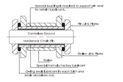

I would agree with the points made by romke. The most important consideration when lubricating roller chain is making sure the lubricant ends up where it is needed. Specifically the sliding interface at the roller ID/bushing OD and bushing ID/pin OD. These interfaces are not readily accessible, so you need a lubricant with suitable viscosity/creep/penetrating characteristics. A good example is RexOil VSK001. In addition to characteristics described it is also environmentally safe and displaces moisture. In the example described in the OP, the lubricant would be applied at each joint interface between the inner/outer link plates and between the inner link plates/roller end faces. Spraying lubricant four places at each pin joint of the chain would be a tedious and time consuming task, but it would put the lubricant where it's needed and minimize waste.
Just for future reference, there is a type of roller chain called "o-ring chain" that would be a better choice for this type of application. The pin joints are grease-lubed/sealed and require no maintenance.

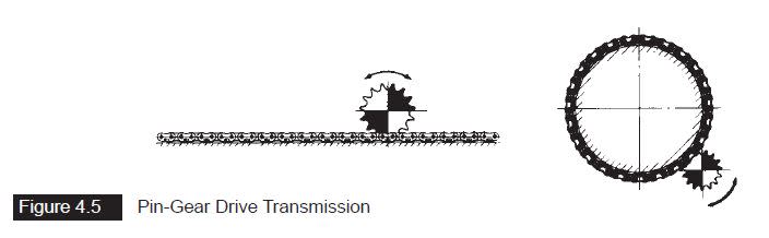

The application shown has stationary chain. The pins do not rotate because the links do not rotate relative to adjacent links. This is referred to as a pin gear drive.
My opinion is that O-ring chain will not be of benefit in this application because only the pin and i.d. of bushing have a sealed lubricant.
Diamond Chain makes a product known as Dura Lube Chain. I do not think it is available in as large of a pitch as shown in the picture, however.
The vertical bushing makes it difficult to keep lubricant in position. Also, limited roller rotation on the bushing means that the lubricant is not distributed.
For this application a roller pinion drive would be a better arrangement.
