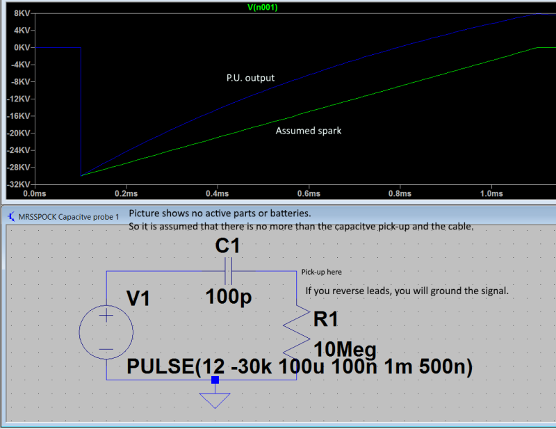

Not so sure how that pick-up is built. But it seems to be just a pair of steel plates connected to the center lead of the (RG58) cable. If you connect that to ground, the signal is shorted to ground. If, on the contrary, there is some sort of amplifier built into the probe, I do not see anything than an RFI core at that end, then it could work. Does the spec say anything about amplifier? Is there a battery in it?
If not, you have something like this:
And then, a simple cable switch doesn't help.
Gunnar Englund
www.gke.org

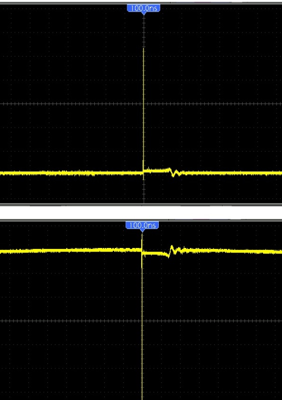

I'm sorry, but I really can't understand why people believe reversing the cables at the scope input will not invert the wave? If the potential has swapped around, the wave must invert. There is no other option. Below is the result of my test with this probe in question, in case anyone is in doubt.

If your scope is true differential, then you already have the isolation amplifier. And then it works.
But if you have an "ordinary" scope (yes, I know that you are using Pico, but not what model) then most models have a much larger capacitance from the "cold" (or GND) connector to Earth than from the "hot" (center) connector to Earth. And in most cases, there is a direct connection to Earth.
So, if you swap leads, you will load the signal (capacitively coupled spark signal) in a way that makes both quantitative and qualitative measurements impossible. And, if the cold connector is grounded, you will not get much signal at all.
The screen you show seems to be taken with a symmetrical front end. If so, your problem wasn't a problem from the beginning. What Model do you use? And what SW? The screen shown doesn't look like an ordinary Pico screen.
Gunnar Englund
www.gke.org

I'm afraid that is much too scientific for me. I just know I swapped the leads and got the result I wanted. I can't see how it can do otherwise if my signal source is a completely isolated entity from the oscilloscope. i.e. they have no common connection to a mains supply and hence don't share any kind of common ground. I just used my Hantek to prove switching the terminals would swap the trace about the horizontal axis. My ignition system is a car with no connection to earth, so it is completely isolated other than the cable coming from this capacitive pickup. If any independent scope is connected to such a pair of wires, and wire A is at a higher potential than wire B, I don't believe the scope can tell you B is higher than A unless the INVERT option is active on the said scope.

Yes, it is DC isolated. But a pulse like the one shown (known as a Dirac pulse) contains mostly high-frequency AC. And HF pours, like water through a sieve, through capacitance. So, even if the insulation is good for kV, you will not be able to do any measurements worthy of the name. If you are after timing only - then you don't have to bother much.
Gunnar Englund
www.gke.org
