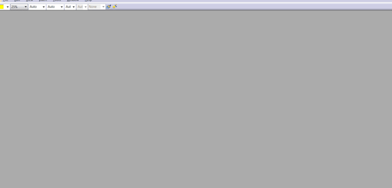

I saved a big 3D Assembly file as a CGR file.
I did the same with a CATPart file.
Now, I want to add it in a new CATProduct(I know that I can't open direct a CGR file in Catia).
Unfortunately, I got the message below:
Do I need to adjust some settings in Option?
Thanks for your time!

RE: CGR file management
Check your search order. Add the path to cgr file.
"Search order check"......What do you mean by that?
How to add path to CGR file?................
I wanted to say that maybe you don't have the path to cgr file in your present search order (if you are working with a specific search order).
Probably you know how to add a new path to your search order, just in case I done a gif file to be more clear in my answer.
