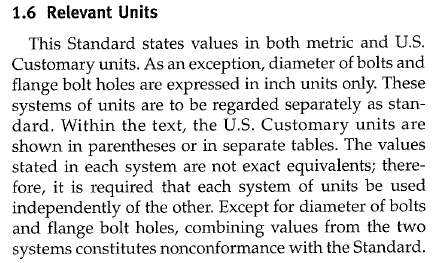

Quote (Michael Kolbuc)
but I can't find anything saying that B16.5 bolt size is just recommendation and M20 bolt will work just fine
Nor will you, I suspect. From B16.5-03:
So, I'd say you cannot use your 1500# flange at the B16.5 pressure-temperature rating.
You may be able to prove it by other means such as Sec VIII, Div. 1, Apx 2.
Regards,
Mike
