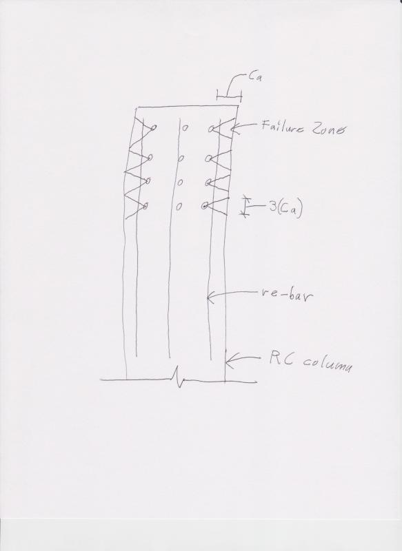

Thanks WARose...I get the twice the load cap...my question is what would the failure plane be so that I can determine if I meet 6.2.9, or I'll try to add rebar to prevent a shear plane from opening. I just can't figure out a failure mechanism for Vcbg to know what/where to put rebar.
As an aside, I'm not convinced that Vcbg calculation would accurately predict anything for this application...but it is the code!
RE: Concrete Column with Embed Plates
As far as the embed plate goes....it's not embedded deep enough to consider as a alternative mechanism for failure. I think one thing that would trip it up right off the bat would be the bearing on that edge being too excessive.
As far as the re-bar goes.....you could treat it like shear reinforcing (in Appendix D): anchor the re-bar in the failure zone and develop it beyond that. The interesting question with that would be the development length to use......compression or tension? I would think compression....but not sure.

Ultimately there is no way to make numbers figure for the column without 6.2.9 anchor reinforcing. The question is where is the failure plane. I don’t know...see below for my thoughts but again I think app d falls short on this

To me, it would look something more like this (by code):
Obviously, you'd be limited by how much the bar develops in each "failure zone". The force in the bar would be cumulative, and you would develop it fully once the studs end. Capacity would be X number of studs * the afore mentioned capacity.

I'd think the shear breakout "failure" line would extend to the rear face of the column and the remaining chunk is resisted from falling by the foundation so in this instance this type of anchor failure would not produce a structural failure per-se but an unsightly crack thru the column depth. (blue line)
Tension breakout and shear pryout would be likely failure mechanism which I would think would create a failure plane that returns to the same face of the column as the emebed (yellow line). There is likely going to be some incidental moment created by the construction tolerances allowed. I would make sure to spec a slotted connection for at least one end of this beam as well, got bit on a job with an embed where beam was installed in summer building was still open in the winter and the shrinkage failed the embed.

I'd agree that the failure plane is as per WARose's last post, this is how studs fail close to an edge. In reality the studs failure surface from individual studs are going to overlap for any closer studs at larger edge distances forming one larger breakout zone.
I'd also point out there is a tension on the central row of studs in carrying the eccentricity moment from the simply supported beam. because your beam cleat is central, all of the tension load goes into the central row.
On the assumption of the plate being relatively stiff in plane each row of studs could be assumed to take ~1/3 of the shear, with the outer rows only taking shear, and the central row taking an elastic distribution of tension force (higher tension on top studs, compression at base of the web/fin plate)+ approximately 1/3 of the shear.
As you are no doubt finding the concrete breakout strength won't give you a lot of capacity especially when close to the edge, you might need to justify additional shear stirrups/ties in the column with a strut and tie, or redistirbute studs to have more edge distance to engage more concrete and/or to anchor stirrups past the failure plane which I believe is/was allowed in appendix D.

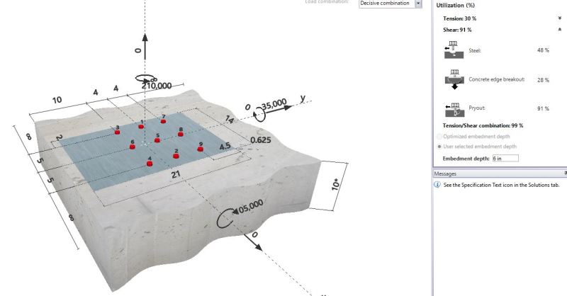

The failure mode that you're looking for here is pryout. I would include an eccentricity off of the face of the column as JAE suggested but, even without that, there is still an eccentricity between the shear at the face of the column and the locations around the failure frustum where the shear is ultimately resisted as some combination of bearing and shear. With infinite edge distances to the sides, that's your classic frustum of concrete behind the plate. With 6" side edge distances and 6" studs, the pryout failure probably starts to take on a character similar to what WARose has proposed. Since your side cover is less than 1.5 h_ef, those local failure are not necessarily precluded. I imagine that your failure is the lesser of the value obtained looking at a local stud blowout and that obtained looking at a whole frustum pryout.
To the issue of scale, I did the embed shown below this morning. Similar proportions, infinite side cover (wall), and lots of eccentricities. 35K capacity; maybe 60K with the misalignment eccentricity removed. The real plate has another row of anchors making the layout symmetrical. Interestingly, capacity is higher with those anchors ignored as the the most demanding local stud failures are not considered. I'm sitting on the fence regarding the validity of the design check but that's a subject or another post of my own.
Your supplementary reinforcing here, for pryout, would be your column ties I think. That said, I'm not sure that we're allowed to use supplementary reinforcement to address pryout.

Right. My sketch was based on the studs being "far" from each other (to get more capacity). If it's close enough to where the zones overlap....it will get more like Celt83's sketch.
I wouldn't agree with Celt83's sketch for shear failure surface, maybe for tension the failure surface would be at the head of the studs. For shear, failure starts at the surface at back of plate/stud weld region like you implied and as shown in many of the figures in ACI code (its just a trapazoidal shape when they overlap but the same fundamental failure surface)
