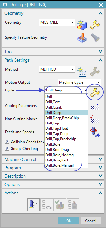

Ok, looks like drilling, single moves, drilling with chip removal does close to what I want i.e. peck drilling. What I can't see is how to control the depth of the first 'peck' - this is important to control depending upon the material type being drilled. Any one know how this works?

I'll admit I don't do a lot of drilling and I usually copy an old operation that uses the old "peck drill". It looks to me that "machine cycle" uses the CNC canned cycle in the post proccesor and "single moves" generates individual moves without the canned cycle, but that probably depends on how your post-processors are set up. " I think you're going to have to experiment with "Drill,Deep" and "Drill, Deep, Break Chip".

Yes, the old drilling types, which are called point-to-point, have been deprecated. I'm not even sure if they are accessible anymore without enabling them.

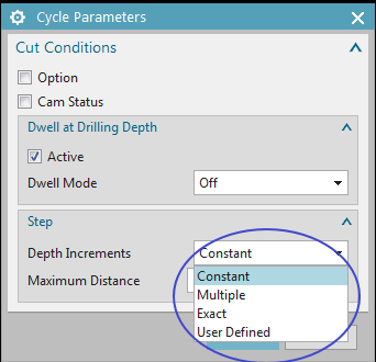

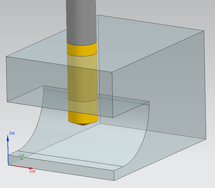

For peck settings in a drilling operation I believe you need go to Path Settings-Cycle and set it there. Depending on your post processor...Drill should output something like a G81 or G82 and Drill,Deep should output a G83. For the latter you will have options to set peck to whatever you need.

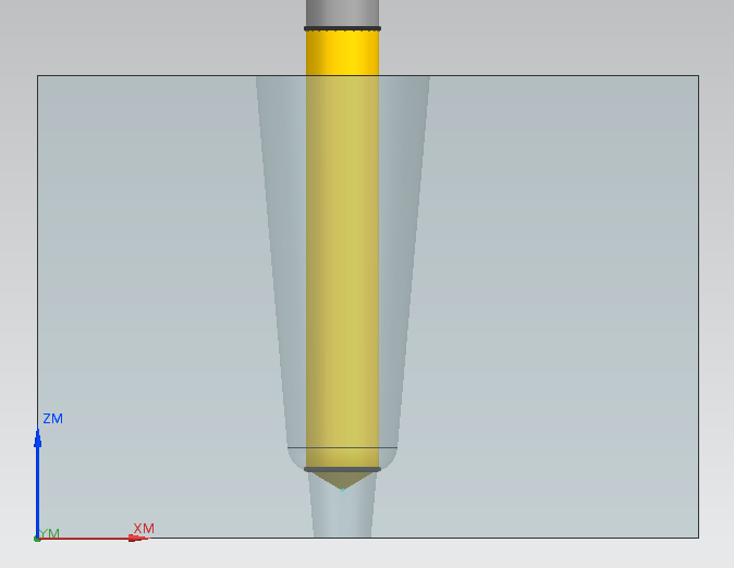

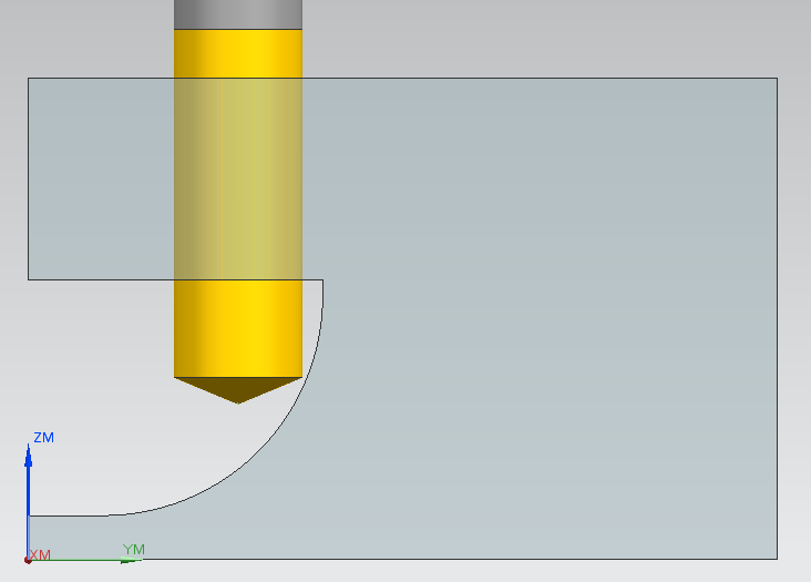

If you have NX docs, Hole Machining Topics has a lot of useful information and you will probably be surprised at how much you can do with Hole Making operations. There are many different types to cover just about anything you need to do. Being totally model aware, Hole Making has the ability to handle conical holes, how the drill handles holes with different floor types (flat/conical drill tip), has control over the depth of either drill tip or shoulder past through holes and also how to handle geometry that exists below a through hole. Also, if your amount and type of work is suited for it you may find the uber automation in Hole Making useful but if you have only occasional need for drilling then you can always go manual as well. NX is flexible like that; makes programmer life a breeze.
