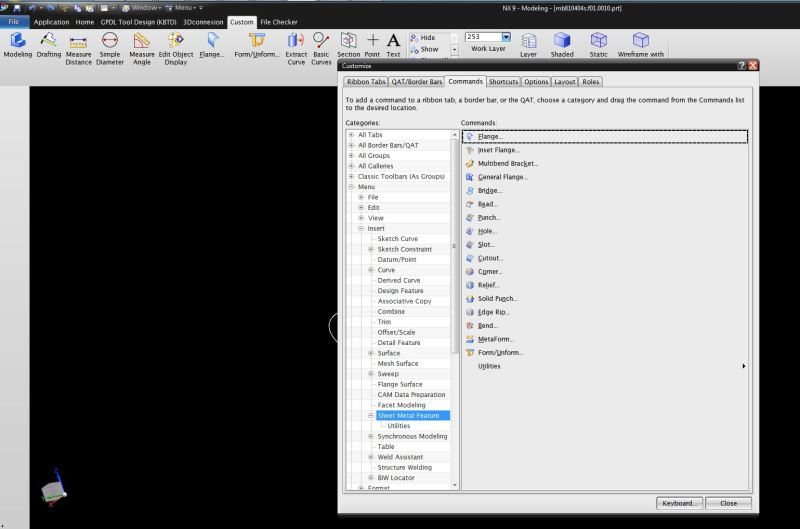

In NX9, when in modeling, we could go to Insert - Sheet Metal Feature - Flange
There was also a different flange option in sheet metal application but this one was available in modeling.
This one would allow you to select an edge of a face, and fill in the Infer Width(which was grayed out at 100 because it would use the entire surface length), Tangent Length, Bend Angle, and inside radius. It would then extend the face out, bending it to the angle you put in, and extend the surface flat again for the length you placed in it.

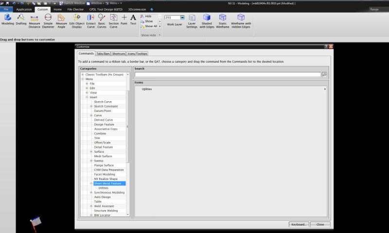

Is this feature still available in NX11 anywhere? I cant seem to find it.

Hi Kenja,
starting with NX 3 SPLM introduced a new module called "NX Sheet Metal". The old in Modeling was called "Sheet Metal Design". Both modules existed in parallel for a while. In NX 9 (or 8.5) you had to set an environment variable that Sheet Metal Design was available. In NX 12 this is finally over. The approach and design in NX Sheet Metal differs a lot from Sheet Metal Design. In the meantime the new module is pretty good.

Though in NX( what we had was called "Flange" and was in a directory INSERT -> SHEET METAL FEATURE.
The closest flange I have found is the one that is in the Sheet Metal application. When I open it, this looks like it has the same info for it, but this doesnt seem to work on solid bodies, as it will not allow us to select any edges of our bodies.

I would encourage all sheet metal users to use the NX Sheet Metal application - it covers 99.9% of all the functionality available in the now unsupported Modeling Sheet Metal Design commands that were retired in NX7.5. The functions were made available under env var for a few releases while the new sheet metal application was introduced. Now, from NX11, that use is restricted.
If something is not there and you are left without a function from NX11, then contact GTAC. They will pass on the issue to the development team who are pro-active in ensuring the legacy features are covered. If users continue with the old function then Siemens has no way to respond to missing functions.
