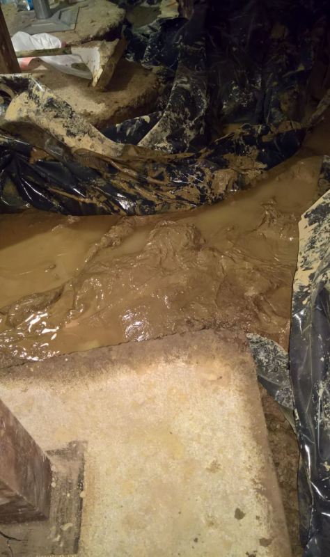

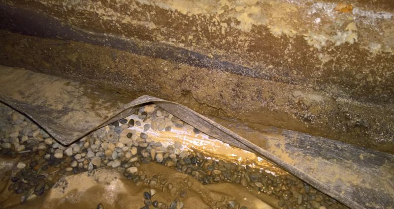

In order to fix the crawlspace water problem, I installed a drainage system with perimeter trench + perf pipe + sump pump. Everything has been installed correctly and it's working. But currently there is still some standing water and I believe the root cause is the leakage of the trench. Here are some clues:
1. The soil type is clay (in some areas the clay contains gravel and sand)
2. The surface soil (4 inch) is mud and standing water, but the soil under that is totally dry and solid (I tested in many areas, which can prove that the water is not from underground)
3. The boundary of trench is mud, 80% of standing water is near the trench. which means the standing water comes from the trench
4. Water level in the trench is not high
Does any one has solution to solve this problem? Thanks a lot!
BTW, the sump pump pit is in the middle of crawlspace and just next to a pier post. Do I need to worry about the post?

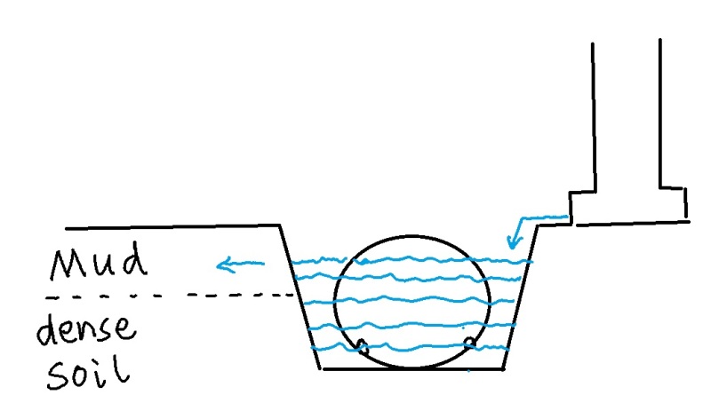

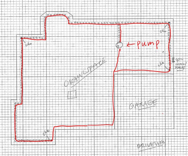

In order to understand, please attach some sketches. One should be a general plan drawing (looking down on the basement layout). Also some cross sectional views. the more detail you can provide, the better the results. Amy idea as to where the water does come from would help also.r perforated pie. What type material, hole sizes and where located in the perimeter, (bottom only, etc.? )? Any backfill to the pipe and what type material? I am wondering about proper filter there. On the cross section drawing draw flow lines, those lines that show the flow paths of water from its source, through soil and to the trench or pipe. The cross section should be to scale at least vertically. These lines are roughly parallel to each other and do not cross. On the cross section show soil types that you are sure of.

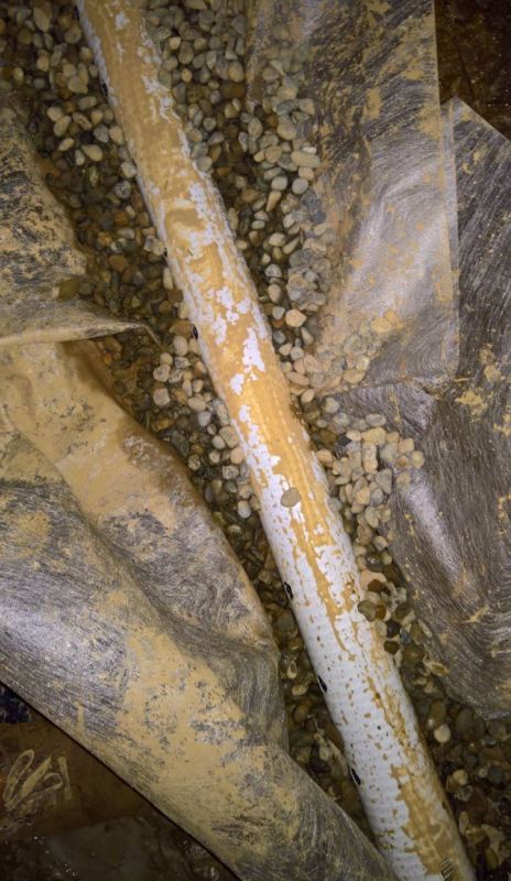

The water comes from the bottom of foundation wall footer, the footer stands on the surface of crawlspace soil and can clearly see the water flows in.
The trench is just next to the footer, 5 inch deep, the PVC pipe sit on top of a layer of fabric and gravel is on top of the pipe.
The system is working well because i can see the water flows into the sump pump and the water level in the trench keeps very low.

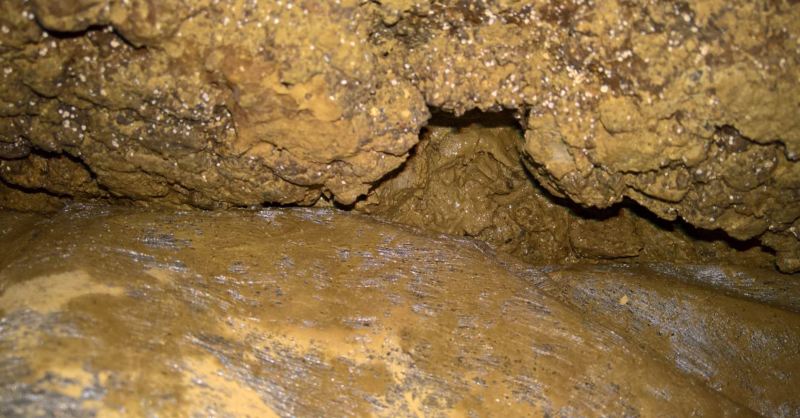

Let me try my best to answer your questions because I'm not professional.

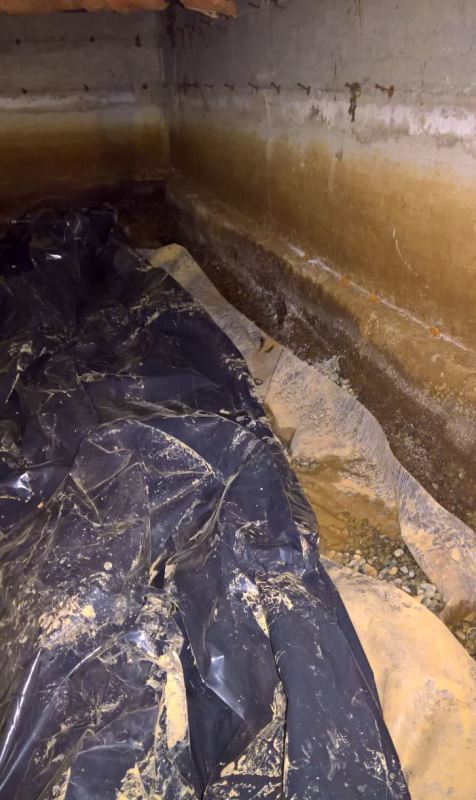

We are at the low point in the neighborhood, according to the line of white powder on the foundation wall, the water table outside is 5 feet above the crawlspace soil.
I attached some pictures.
The pipe is just installed, and as far as i can see, the water is flowing to the pump and the surface of gravel is dry, which indicates the water is not over flowing.
I dont know how to tell if the soil has any erosion.
The pipe holes face down.
I'm sure all the soil type i see is clay.

4. I dug the soil under the standing water, only the 2 inches soil on the surface is wet and muddy, but the soil below is very dry and solid. If your theory is correct, the underneath soil should also be wet, right?

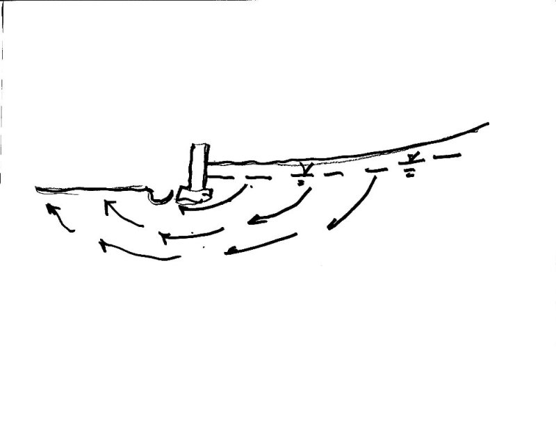

Do you think it's possible that the water actually spreads horizontally through the muddy layer as illustrated below?
I don't know why the soil 2 inches below is so much dense than the surface, but is it possible that the dense soil will turn to mud as it's under the standing water?
I can live with the 2 inches standing water if it will not cause obvious settlement to the posts and piers.

Assuming your drawing is to scale, any excavation below and next to the footing grade is questionable. If you have a dense WELL GRADED gravel as the trench fill, maybe no problem, but I suspect single sized stone even if compacted won't provide much resistance to a slip or settlement. Liken that gravel as bunch of marbles, or nearly so.
With your question, if your "clay" has any montmorillonite mineral or other expansive mineral, swelling can occur.
Many areas of the world have expansive clays, but I suspect yours is not the "real worst stuff" or you would notice heaving and settling as moisture changes through the years and seasons. In technical terms that soil may not be what we define as clay, but coarser material likely in the silt range. For that house age, I suspect nothing unusual would result in the future with water there, or you would have noticed that long ago.

The footer is fully exposed in the crawlspace, which means the trench is below the footing grade. I'm really worried now. The trench is 5 inches deep and 6 inches wide, and 5 inches away from the footing. What should i do now to prevent the slip and settlement? Thanks!!

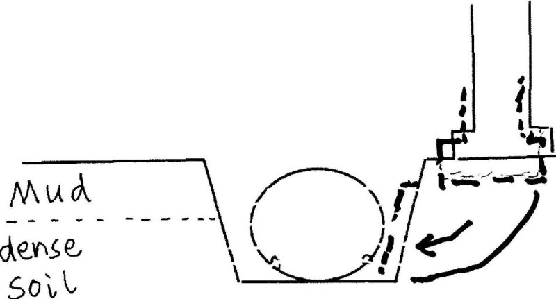

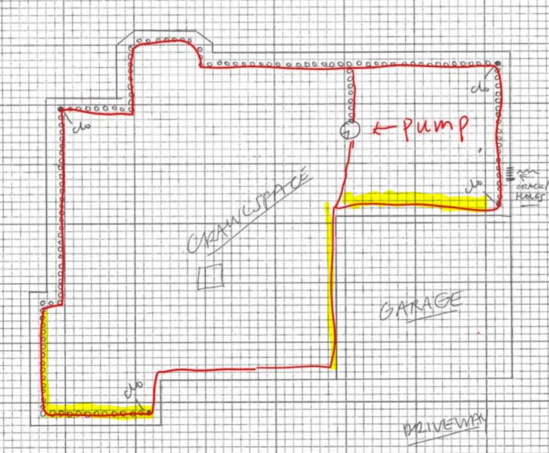

I just checked again and realized that two trenches were dug just next to the foundation wall, and the soil under these footers is already very soft. What should i do now? Will it work if I change the trench to a concrete trench (a trench built with 2 inches thick concrete)
RE: Water leak from crawlspace trench
While I may be able to advise on these matters usefully, there may be something I don't know that is important and may affect things. One of those factors is exactly what is the soil and ground water situation at your place? Unfortunately you may have caused some serious problem with the trenches next to footings. Then again, maybe not. At this stage, I'd check the yellow pages on a large community, perhaps even a few hundred miles away, if necessary, and see about AN EXPERIENCED geotech engineer, under ENGINEERS, CONSULTING section. Someone with at least 10 to 20 years experience in geotechnical engineering would be the start. I'd ask for a site visit st start and then there may be the need for some test borings or other examination there. This person should have experience working with specialty contractors, such as underpinning experienced contractors. A VERY experienced structural engineer may be OK, but someone with experience in underpinning foundation ENGINEERING would be best, not just a contractor. It may cost something not expected, but at least a visit to start is needed. My thought at what I see is that the adding of load on your filled trench and against the footing would lessen the chance of problems. A dense material that will not only filter some weeping water but also have better resistance to movement is the mixed sand and gravel that is the aggregate for concrete. A clean mix of sand and gravel would be OK, but there should be no silt that would clog the voids. Place that on the trench backfill and against the footing in 6 inch layers, each thoroughly tamped as with a 4 x 4, 4 ft. long is a start and maybe all that is needed. I'd tamp it into that soil under the footing where exposed also. I'd stack it up at least as high as the footing top there and taper it out, removing that plastic sheet first. I'd examine the walls carefully and look for cracks. At any cracks, old or new, clean off the dirt and draw a pencil or deep scratch across the crack. Then put two cross lines on that line, 2 inches apart. Keep a record of the distance between those marks, as well as any change dimension of the main line where it might displace in-out, up-down.
I'd start any filling like described above at the mid point of affected walls, since there is the most need for improvement. Adding concrete may sound good, but you need a way for water to travel also.

the purpose of all these actions are trying to avoid the soil to be reduced under the footer, correct? But why the soil is so soft underneath the footer? I thought they should be as hard as rock, is it because of the trench too?

I'll consult someone about this as you suggested. I highlighted the impacted foundation walls below, luckily the majority of them is the garage walls, which do not take roof loads. And my foundation walls are concrete pouring walls which are not easy to crack. BTW, i failed to find the JKG, can you share his information here?
