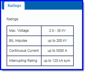

Hello all,
Would you please tell me if you know Is Limiter manufacturers other than ABB Calor EMAG,
for current limiters 11000 V, 3000 A, 50 HZ
Best regards,
Kevin.

Hi Kevin,
I haven't seen any competition to the ABB IS Limiter. In doing some Google searching I found this Schneider Electric paper detailing a similar approach, however I couldn't find any additional information on their product.
https://www.schneider-electric.co.in/documents/sup...
RE: Hello all, Would you please tell
G&W Electric. Current Limiting Protector "CLiP" explosive actuated fuse.

Please disregard my earlier response. We were using the CLiP fuses on 13.2 kV circuits that fed secondary networks (208 and 480 volt). My apologies.
