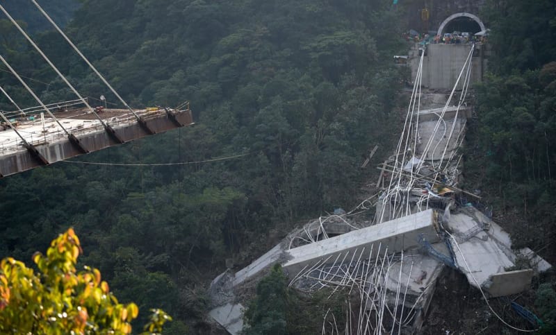

A major bridge, 440 metres span, collapsed during construction. Seems to be a cable-stayed bridge with concrete towers and deck. Seems like one tower and span collapsed during construction, killing at least 10 workers.

Those towers look "hell for stout" but the deck seems really thin. Not that this likely contributed to the collapse.
ETA: the thin deck caught my attention because the bridge was located in a narrow valley, a frequent source of higher winds, and bridges located therein are susceptible to vortex shedding loads. The deck of a cable stayed bridge is likely okay, although the issue has affected the stay cables on some such bridges.
RE: major Colombia bridge collapses during construction
It looks like it came nearly straight down, which suggests to me that the bottom of one of the inverted V struts blew out. If it was a deck failure I'd expect the failure to be on one side and the unbalanced tension to pull the tower the other way.
I see that the roadway is off to one side with the top of the tower pointed the same way; this is also what I would expect if the strut on the other side failed first.

Given that it failed when both half-spans were nearly complete, and cantilevered waaaay out, I'd wonder about a wind-induced lateral torsional resonance around the center of the tower. They do look stout, but not so much in torsion around their central vertical axis.

Maybe a foundation failure? Almost looks like the tower is trying to rotate to the left and away from this perspective. Hard to tell for sure. The strut clearly ruptures after the tower starts moving though.
IC
The upstream (land-side) cables in the video all slacken nearly immediately. At the same time, the two V-beams relax (spread out) from each other as the top of the vertical column pulls down. Seems like the problem would be the vertical capacity of the split-Vee tower.

Looks to me that the back span on the failed section was a lot shorter than the one still standing...
Mike McCann, PE, SE (WA)
It's not easy to see from that video which is though the best seen so far, but it looks to me like the first two cables just to the left as we look at it from the main tower start moving and flexing just before the rest. Would therefore look like the far strut of the V collapsed before anything else di, but it is not easy to see cause as opposed to consequence.

I am with LittleInch on this one, my take on the video (@ 0.25 speed on Youtube) is the same as his.
On the 'sudden failure' aspect, would that suggest the furthest fork failed in shear right where the /\ section joins the V of the fork?
That said, it looks as though there is a good amount of dust kicked off the inside of the furthest fork - which I suppose suggest the concrete has essentially 'exploded' under the compression load running around the inside of the fork at bridge deck level. Or perhaps it is the re-bar being ripped out of the concrete?

If you look at the tower that's still standing, there's a concrete diaphragm wall between the two inclined piers up to the deck level - e.g. see:
https://www.msn.com/en-us/news/world/colombia-brid...
This photo also suggests a beam or corbel on top of the diaphragm wall, which looks like it supports the roadway deck. Presumably, one of the functions of the diaphragm wall and / or the top beam is to resist the spreading force of the two piers?
It's hard to see this wall in the collapse video https://www.youtube.com/watch?v=QSU8GozlAKc, but if you look carefully , you can just about convince yourself that "something" explodes between the legs, and at 0'14", you can see a dark line down the centre of the far pier - is this where the diaphragm wall just pulled away?
Is this a case of inadequate horizontal tension capacity (either by poor design / detailing, or construction defect) of the diaphragm wall between the two inclined piers?

Here are my observations from the posted videos.
There were tower cranes next to each tower. A red one next to the remaining tower and a blue one that is now in the rubble.
It appears to me the initial failure was a tension failure in the diaphragm under the deck that was holding the two V-struts together. The deck is entirely supported by cables so I doubt that thee was any deck loading onto this diaphragm or the beam at the top of the diaphragm.
In one picture there are the tops of what appear to be two towers that are visible behind the mountain in the background. There maybe another similar bridge on the other side of the mountain. Perhaps the $2 billion dollars is the cost of the whole road project and not just this one bridge.

Unfortunately I don't think the video actually captures the initial fault. Right at the start of the section with the collapse if you pause and look at the cables closet to the tower they are already not straight and not under tension so it look to me like the tower had already started moving at that point.
I'm struck by a couple of things.
One - how similar is this bridge? https://www.youtube.com/watch?v=ErBcdjgGtv8
The key difference is that the collapsed bridge is really a tower supported cable stay and is not symmetrical. I can only imagine that once the longer section exceeds the section length attached to the hillside, then as it extends outwards you constantly need to tighten up those three supporting cables anchored to the hillside to prevent any bending of the slim tower structure. I doubt that structure can withstand any bending load but how you accurately monitor the bending is maybe a key issue?

When you watch the video of the collapse, it appears as though the first thing that happens it the cables on the far side relax and almost simultaneously the lower section of the far side of the tower begins to drop, the web explodes and the bridge deck beyond the tower drops but the bridge deck between the tower & the abutment remains stable until the tower completely fails. So it seems the deck between the tower & the abutment was shored. I wonder if much engineering went into the loads the shoring was placing on the slope above the tower's pile cap?

As others have said there was a horizontal 'slab' at the top of the diaphragm wall. However looking at this photo in particular Link, examine the reinforcement in the remains of the wall vs that in the 'tee' at the top of the wall on the right side. Notice what looks like essentially undamaged concrete on the right side as it lies?
This suggests to me the tee might not have been adequately connected to the V columns, also of note is the large amount of reinforcement exposed in the diaphragm wall, but nothing similar visible in the tee (nothing exposed to the same extent at least).
I'd expect quite a lot of reinforcement in the 'tee' if you consider a strut/tie model of what is going on. Distributed wall reinforcement won't achieve the same. Combined with what others are saying it may have simply unzipped at the pier/tee intersection due to insufficient tie reinforcement tying the two sides of the pier together.
