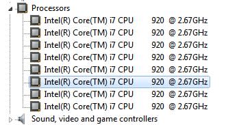

Is it possible to install nx11 on this CPU

RE: Is it possible to install nx11 on this CPU
according to this document it should.
NX11 requires SSSE3
Hi robnewcomb and thank you.
Is this SSSE3 should be noted.
Ivsee that my CPU is core i7.
Is this mean that my computer is ok for nx11

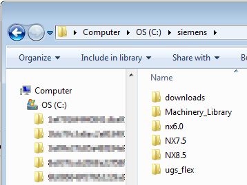

But I hesitate that the installation will injures
my current version.
I have NX6 - NX12 installed on my laptop, on two separate disks.
NX6, NX7.5, NX8.5 on the C:\
NX9, NX10, NX11, NX12 on the D:\
Regards,
Tomas
Regards
Tomas
