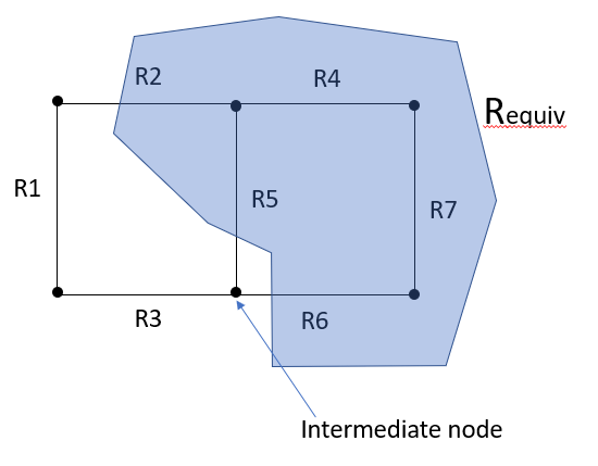

Hiya Sparkies!
I am sure this is going to be a very noob-sounding post, but it's been a few years since my Circuits class...
I have what is essentially a ladder-shaped arrangement of resistors. Each "rung" of the ladder is a resistor, and each segment of the "legs" from rung to rung is also a resistor. I can't disconnect any of the junctions, but I'd like to know the resistance of each segment. I can check the resistance from any junction to any other junction pretty easily, but I know that every measurement I can take is going to end up with a bunch of parallel resistors in the path.
I can't assume symmetry of resistance values on any portion of the ladder, so I am guessing that if my ladder has "n" resistors then I need to take at least "n" measurements, but I don't have a great idea how to set up the measurement points and forumulas/algorithms I should use to do this most efficiently. My fear is that it ends up being a huge system of equations with "n" unknowns, and "n" is in the neigborhood of 30.
The other wrinkle is that I am afraid that variability in my measurements may lead to a system of equations that's un-solvable. The resistance values are (ideally) in the 10s of ohms range. Right now the measurements are taken manually with a DMM, and I can't be entirely sure that if I measure from A to B, then A to C that point A was exactly the same point electrically. At some point I hope to build a jig with multiple probes and switches such that I can take every measurement without moving any probe and just switching the electrical paths. I hope that makes sense... any input or guidance to kick this off in the best direction would be appreciated!

Decades ago, I was involved in In-Circuit Test (ICT) of assembled circuit card assemblies. Measuring resistances was made trivial, even with parallel paths, because the system allowed us to simply specify a list of nodes to be guarded. The system applied the necessary guards.
To be clear, if the parallel path didn't contain any intermediate nodes, then it couldn't be guarded.
For example, if the circuit had two 1k resistors in trivial parallel, then one simply looked for 500 ohms.
But if the 1k resistor under test had a more complex parallel circuit (such as two 500-ohm resistors in series), i.e. the unwanted parallel path having an intermediate node, then the guards would be applied to the intermediate node(s), within the parallel path, and the desired and correct 1k measurement appeared like magic.
The ICT system made it very easy.
Given measurements of a network with a handheld DVOM, you might be forced to just perform sanity checks of each resistor, and compare it to the calculated value using circuit analysis.

Thanks, VE1BLL! I had never heard of that "Guarding" technique before. Ignorance of an ME...
Here's some more ignorance:
Based on my "ladder" type grid layout, I always have at least one intermediate node, right? Such that, given the picture below, if I want to find R1 I can apply the guard at the "intermediate node", and the equivalent Requiv becomes the R2 from the NI diagram? Does that sound correct?
RE: Analyzing a grid of resistors
Guarding is one approach, but brute force and ignorance can go a long ways. If you shorted the distal ends of R1 and R2, you'd only be measuring the parallel resistance of the two of them.
The objective of the guard is to drive the voltage across R2 or R3 to zero. If the voltage is zero, then there is no net current flow away from R1 into either node. which effectively isolates R1 from the circuit.
Ref your image, to guard the measurement of R1, you'd guard the right hand ends of R2 and R3 (two guards). Similarly, guarding the measurement of R5 may require four guards. This is based on my experience with a very expensive (megabuck class) ICT station with plenty of Guards available.

As I understand it, to measure R1, you must guard either R2 or R3 but not both.
For example if you guard R2, there will be no voltage and no current flow through R2 or through the R1-R2 connection, hence no need to guard R3 or R5.
Bill
"Why not the best?"
Jimmy Carter
Per Kirchoff's current law, that would be correct for the circuit shown. The zero net current going through R2 ensures through KCL that no net current goes through R3, i.e., conservation of current.
For measuring R5, both R3 and R6, or both R2 and R4, would need to guarded, but not all 4.
