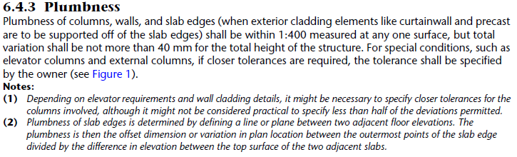

With that level of out-of-plumbness, I question how do you build the wall above and think of the disaster it will be to finish it. I don't know about the ACI code, but I thought the CSA code somewhere has limitations to out-of-plumb tolerance.
edit: found the code reference in the CSA code

ACI 117 has concrete tolerances. NAHB's Residential Construction Performance Guidelines is another reference. But, if there isn't a contract referencing either of these standards, I don't know what the options are. I have never done any residential work. All of my projects have had specifications that reference ACI 117. Have you check to see if the residential code has any construction tolerances? 5" out of plumb is a lot.
RE: Out of plumb foundation wall
The issue isn't tolerance at this point. The residential drawings actually require ACI-301 specs which reference ACI 117, so this thing shouldn't be more than 3/8" over the height out of plumb. (Difficult to know what to use for a foundation all as the foundation section doesn't cover it and the competent sections says starting at the foundation) I used structure, cause there is nothing relevant in the foundation section.
