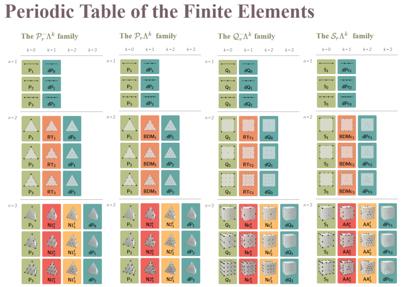

Besides tri, quad, tet & hex are there any other element that have been used in FE?
Not bothered if they have been successful or not (probably not as I would have come across them by now I guess)

Beams, springs, truss/rod, connectors, rigid body elements, etc. are all commonly used as well.

Wedge and pyramid elements in 3D.
What about elements like axisymmetric, plane stress, plane strain, infinite, gasket, cohesive, frame, etc.?
RE: Are there other FE elements types beside the Usual?
All sorts of specialized elements such as crack tip elements, those for VCCT, etc.
One way to organize it would be to use a flowchart and start at the highest level, 0-D, 1-D, 2D, 3D elements. Then break those down (i.e. a 2-D element can be a tri or a quad...with varying number of possible nodes per element). Then break those down (i.e. a quad can be plane stress, plane strain, axisymmetric). Similarly a 1-D element can be a beam, truss, spring, etc.
If you look at an ABAQUS, NASTRAN, ANSYS, etc. manual, it will discuss the possible elements for a given solver.

Your examples are 2-d and 3-d elements.
Then you have 1-d elements, typcally connection 2 nodes. They can be beams, rods and so on.
And you have 0-d elements, a single node. Like a concentrated massa or certain springs. I don't know if "0-d" is a commen term but I have seen it in some texts.
Then there are special elements och special element formulations. Some already mentioned in the thread but there is more. It also depends on that software we are talking about.
