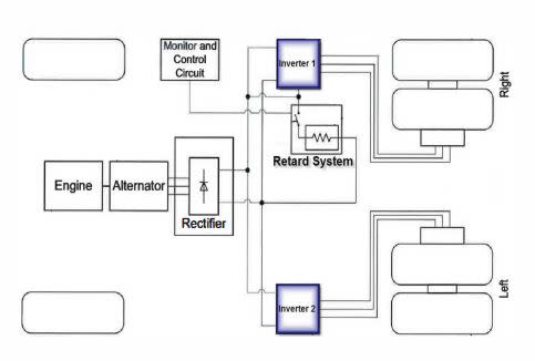

I need to design a Grid Resistor for a Given electrically driven Haul truck.
we have two 1400Hp traction motor for propulsion. in retarding mode they will, of course, generate some more power, let's say around 1600. considering these two there will be up to 3200 HP in retarding mode. We need a resistor that would cope with and dissipate such a power in the form of heat energy.
So, does anyone know about know-how of designing and testing a Grid resistor for an electric mining truck? what parameter should be taken into account? what are governing formulas and physical laws?
Any would comment be appreciated.

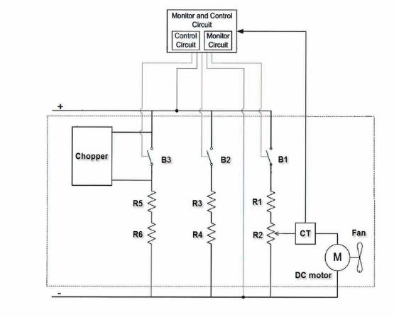

actually, thanks to hours of searching the net regarding this issues, I know about supplier very well. Further, the end user of resistors also knows about suppliers. nonetheless, they are not willing to supply from these sources(Given that the OEM is not available) and want to build resistors technology in their organization. as a project, build the resistor have been assigned to me. I have reverse engineered and built the first sample, but it crashed during the test. I probably know the error source;
As I have selected the resistor element thickness 0.5mm lower than the original design, and it caused the current density increase dramatically and produce extra heat. besides according to electrical resistance formula, R=p*L/s, reducing element cross-section will result in increased resistance. So the cooling Fan which is being fed by resistor passing current will not start or will work with lower RPM. ( in the attached picture you can see the schematic diagrams, where M).
