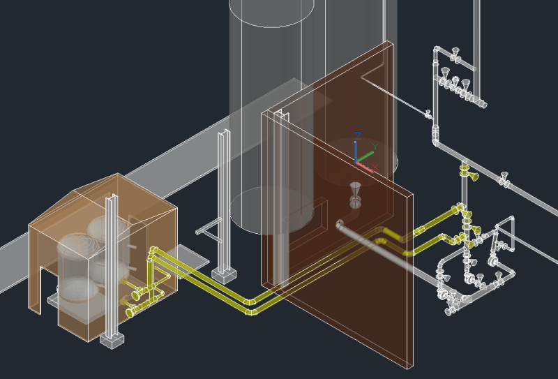

I have some new polisher vessels I am putting in my facility. I plan to use two short runs of 4" SS flex hose for the influent and effluent vessel connections to hard piping. The vessel supplier is showing a male camlock on the influent and female camlock on the effluent. I would think it would be ideal to be the other way around (male going into female in direction of flow). I have done some internet sleuthing and came up empty, but is there any guidance on male/female camlocks based on direction of flow?

BTW having one nozzle directly above the other but both pointing down looks like a poor design to me as both hoses will clash if laid on the floor and access to both will be difficult. I would have thought you wanted them offset by 30 degrees or so.

Thanks for the sidebar on use of camlocks, but I am aware of best use practices. Not sure where it sounds and/or looks like permanent pieces of piping. I only showed the vessel (which you can see it mounted on a skid with openings for forklift tines) and asked about direction of flow. The equipment is removed and sent off site for regeneration. In order to ease the removal and install of the vessels for my operators, I want some flexibility in where the vessels can be located. Additionally, operators won't turn wrenches and maintenance would bitch too much if I asked them to unbolt and bolt these connections every time we swapped out a vessel. As stated, the hoses are short (4 foot in length) to connect the run of pipe to the vessel. See screenshot below, yellow pipe is new pipe.
As for the nozzles on top of each other, the water conditioning company owns the vessels, so that is their design. I can offset my piping to avoid hose clash.
