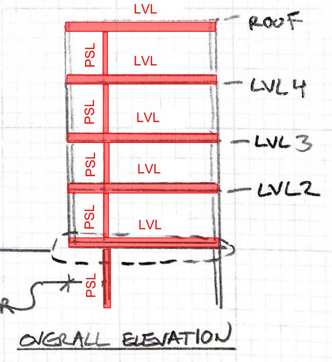

I have a (4) story wood hotel I am designing in normal winds and SDC B. The second floor cantilevers out about 4 feet and then continues up to the roof. We have steel beams on steel columns to support the cantilever but the contractor was surprised at the amount of steel we have shown. I'm wondering it it's reasonable to eliminate one of the columns and have the beam bear on top of the wood wall. There will be welded threaded studs attaching the sill and top plates to the beam.
The other complication is this condition occurs at shear walls - I'm hoping to use my steel integral with the shear panels. I've attached some figures for clarity. The issues I see are as follows:
1. How "braced" is this beam in reality? We have wood floor trusses hung off of the top flange and wood diaphragm only.
2. How big of a deal is is shrinkage here? Obviously the potion over the column is going nowhere but what happens away from the column when the sill and top plates shrink?
3. Is there a scenario where a wood column (PSL or the like) could be subbed in? Admittedly I haven't run numbers on this yet.
Thanks for your help!

I'm with your contractor. Seems like you could eliminate all that steel and probably make things simpler for yourself as well.
- lose the W25x55 by using cantilevered LVL at each level.
- lose the W21x44 by using a relief angle for brick support every other story or so.
RE: Steel Beam Cantilever on Wood Wall
I like Koot's proposal. You could likely limit the LVL beams to only in level 2 and 4. Beam in 4 supports 4th and roof, beam in 2 supports 3rd and 2nd. I think Koot gave you an extra floor in his sketch.

I never like cantilevering LVL's with high sustained loads. They seem to sag more than they should. There also seems like alot of chance for wood bearing/crushing issues - even with the PSL posts.

I would just make the PSL column the same width as the stud wall, provide thick wood sheathing with blocking and lots of nails in the cantilevered portions. This would stiffen up that area and turn it into a combination of plywood box beams to compliment the LVL. Likely cheaper and easier than putting in a diagonal and would act the same.

Great info - I just did a similar layout with LVL's at each floor for a nearly identical plan without brick and it was very tough to get them to work although we made it happen. If you add the brick load at the tip of the cantilever stacking up for (4) levels it seems like it would be extremely difficult to get the wood to work - mostly from accumulation of loads at the bearing point. I would also need to drill through the middle of the LVL's for my shear wall hold downs. So if I had a three ply LVL I feel I could only count on two plies since I'm effectively drilling out the middle. I would feel better with the steel personally and the contractor has expected steel - he just didn't expect as much I as showed. I feel if I can eliminate almost half the columns and foundations I can do a lot to get them closer to their budget.
As far as beam bracing I agree I could (and should) justify a brace point at the column. The tip of the cantilever should be braced at by the beam framing in the side and for cantilevers I thought the top flange was critical for bracing.
