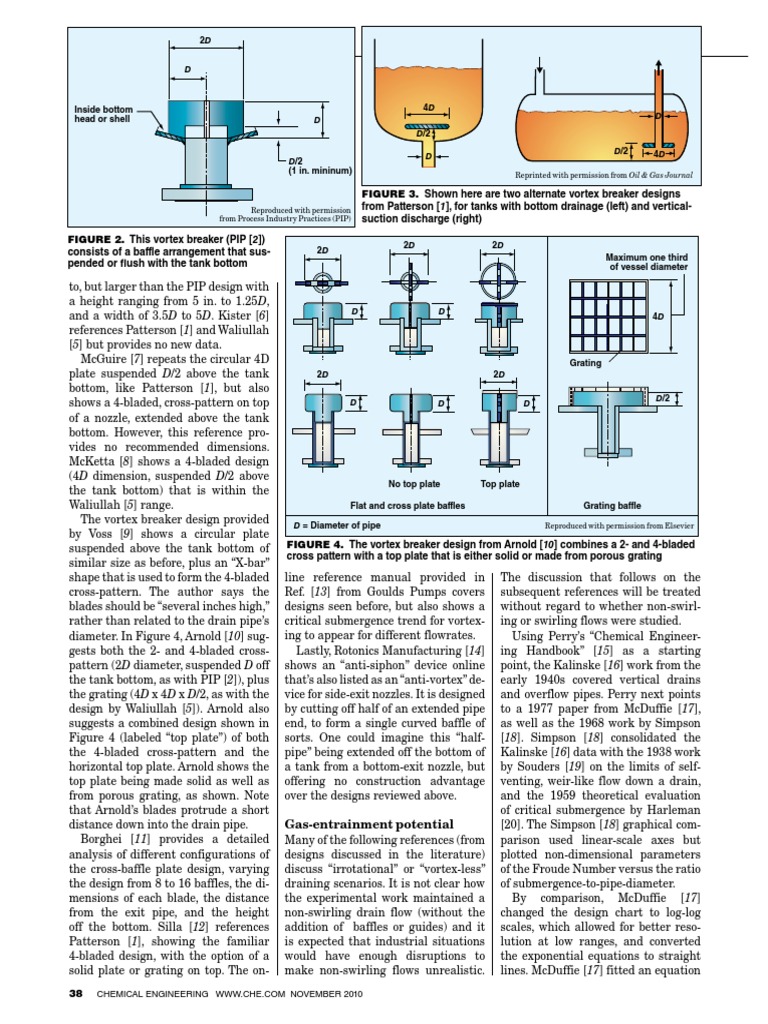

To prevent gas from vortexing down into a liquid exit nozzle, you need a well designed vortex breaker and adequate liquid submergence depth, measured from the vortex breaker top. Vortex breaker configuration may be this cross plate type or a slotted liquid collection pipe. Used to have a copy of the ExxonMobil design method for these many years ago, but not anymore. Offhand, you'd need at least 100mm liquid submergence. Max liquid exit nozzle liquid stream velocity also should not be more than 1m/sec.
RE: Vortex Breaker Article
I am well aware of normal vortex breaker design and design rules for outlet velocity. I am mainly interested in literature articles specifically discussing the benefit of the cover on preventing gas carry under / vortex formation vs no cover.
A number of previous threads have referred to the link I posted in the original post suggesting it specifically discusses this topic. I just want to read that article if anyone saved a copy :)
The flowrate is large hence the DN 850 nozzle and the submergence is adequate based on ANSI however CFD results indicate vapour carry under and that the plate would be beneficial to prevent this. Hence I am looking for articles that discuss this topic.

You say this is a flash vessel, so you've also got to have adequate degassing of the liquid phase before it enters the DN850 liquid exit nozzle. Use Stoke's Law ( or the appropriate expression ) for adequate disengagement of a 300micron gas bubble from the liquid phase. Essentially, the superficial liquid drawdown velocity ( in a vertical vessel say) should be less than the terminal rising velocity of the 300micron gas bubble. This criterion is typically used when the liquid exit stream feeds a pump. A vortex breaker is assumed to be in place with adequate min submergence.
