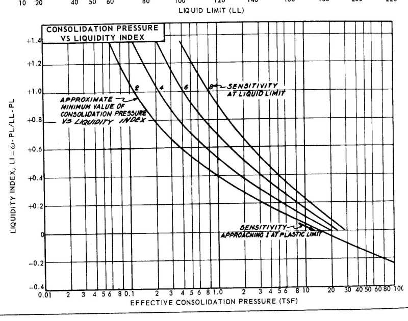

OG back:
I'll post a chart that I have used many times with confidence.
Note how low your liquidity index is.
This indicates your effective consolidation pressure due to low moisture content gives very high load capability. That is why looking at the consolidation test plot may also show something wrong with the test. Errors are very possible there!!! That is something that seems fishy about the interpretation of that curve plot as meaning the correct value. Before getting too involved with the data you have, I'd have an experienced geotech look at EVERYTHING.

Og finally. If I'd be in charge of this field and lab work for this job, seeing the blow count and the FEW moisture content tests, immediately raises considerable question at even the thought of running consolidation tests. Very likely they (or it) are totally useless or unreliable considering the question that the original post raises.. More lab work or field work might be in order if what is available has ANY question as to site conditions as viewed by an EXPERIENCED geotech.

Do you have undrained shear strength values? If so back calculate p' from Su/p' =0.23 as a rough approximation of what p' should be.

Based on:
- SPTs ranging from 20 to 30
- Unit weight of 20 kN/m3
- Low W% and no even close to the LL
- No groundwater
I would not expect underconsolidated conditions. I think that there was some sampling disturbance (looks like they did not use the proper tools), that affected the consolidation test results. Do you have any other strength test results? If so, you can double check your consolidation test results following BigH's suggestion.

I did not receive any unconfined compression results, but Im calculating Cu based on the equation Su/Pa = 0.06*N. For N = 20, Su = 120 kPa. With an Su of 120 kPa, using BigH's equation, the estimated preconsolidation pressure is around 500 kPpa.

I agree that the low liquidity index and moderately high N values are not consistent with an underconsolidated condition. Possible explanations for the consolidation test results might include: 1) The soil is very sensitive and has been badly disturbed during sampling; 2)The sample is of slough that settled at the bottom of the boring; and 3)The consolidation machine is badly mis-calibrated.
