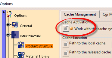

What have you meant by "Working with the cache system to make life easier on your machine when working with big assemblies" ?
How to get that?

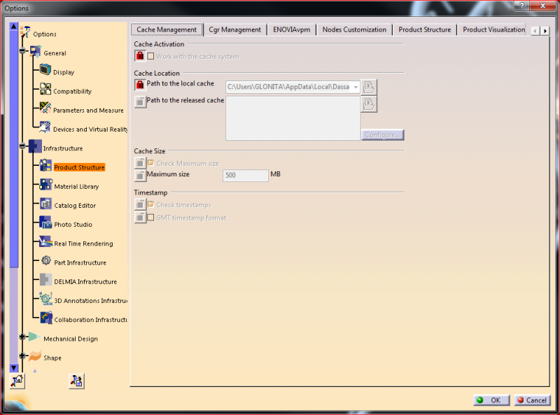

It looks like the "Options" on my Catia is system administrator locked, right?
CAD 2015
RE: Fast Catia Save file.....
Yes. Yours are locked by your Administrator - you'll have to talk with whoever controls your CATSettings.
Working with the cache system allows you to load cgr representations of the 3D instead of the raw CATIA design data. It can help when working with large assemblies where you need to see a representation of the surrounding 3D, but only need to make changes to one part by putting it in design mode.

You can unlock those options by loading Catia in Admin mode. Your administrator should do that for you.
In case he doesn't you have here a link on how to do it yourself: How to Run Catia V5 in Admin Mode
