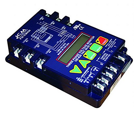

I've tried all the search subjects I can think of and have found lots of really nice phase-loss protection relays but not a single one will trip on frequency deviation. You'd think no one used non-utility power.
Does anyone know of a line freq monitor?
240V, 3ph, no neutrals. It can, of course, be just a single phase.
It will be used to inform a PLC.

Can't do it with a (relatively generic) power meter, either with a discrete alarm contact, or via some form of communications?
I've seen similar things done with over / under speed relays and a magnetic pickup, but that assumes that you are dealing with a rotating machine and have access to it. I'm aware its not the same thing, although for practical purposes it can be close enough depending on the application.
Crompton's 250 series might well have something, its been a while since I looked though, and I was always trying to take them out, not put them in.
Edit: Crompton has such a thing, looks like they've redone their 250 series, look for a 'PHD' part number.

That looks pretty good Freddy! Now if I can just find one.

Part of the reason I kept looking at removing things like the Crompton units (they do the job they're supposed to quite well, but there are easier ways of achieving things these days) is that the all in one controllers do most of the work without custom coding. The approach of using a PLC was better placed when the controllers weren't that capable, but usually had the issues of having to process signals (i.e. using signal processors to bring AC voltage down to a signal level the PLC can handle, either using pulse counters or discrete relays to work out when to stop the engine cranking solenoid).
If you have the opportunity, I'd look at things like the lower end Comap (or even Deep Sea) controllers, the high end ones are way more expensive, but the lower end ones often end up comparable to things like the Crompton relays, most of them have setpoints for both frequency trip, and load shed. If the PLC is already installed and operational, its a different argument to completely replace it of course.

Jeff; great links! I love that meter with 4-20mA output. I'll probably go with that since it's lovely accessible by the car managers, if it's not excessively priced.
