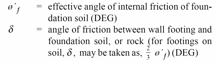

Quote:
5. Probably increases the soil friction resistance for sliding. I have seen this coefficient of friction taken as tan (2/3 φ). Could you please elaborate? Do you mean wall friction value?
See Page 5-48 of CalTrans Retaining Walls. I'm assuming the foundation soil has properties similar to backfill.

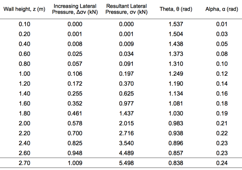

Ok i will apply the buildings surcharge load at 3 meters from the wall, which i have changed to 20kPa (i was wrong about the 10KPa).

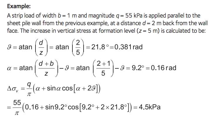

I am looking into text books in order to find out how i can calculate the effect the surcharge load will have on the wall but i am having some difficulties. I have never tried to calculate this with a surcharge load that is at a certain distance from the wall.
I have looked into the CalTrans Retaining Walls paper (page 39, equation (5.5.5.10.2-2)) you posted above and found this equation (see photo attached). This equation is used for a Uniformly Loaded Strip Parallel to the Wall, however my building load is not actually a strip but an RC concrete slab (raft foundation) parallel to the wall (approx, 10m x 13m) , therefore do you think I could consider this as a very wide strip or do i need to use another equation?
The value i get is 8.17kN, which seems a bit high considering that the building is 3.0 away from the wall. Also i do not know at what height (point) this acts on the wall, if you want to have a look i have attached the excel file below, its only one calculation. Am i wrong using this equation?
https://res.cloudinary.com/engineering-com/raw/upload/v1515583756/tips/Surcharge_load_at_a_destance_x_from_wall_n7kqjx
RE: Guidance for the Design of a Reinforced Concrete Retaining Wall
Equation 5.5.5.10.2-3 tells you where the resultant force acts.
The ArcelorMittal piling handbook has an alternative formula. Worth checking a few different methods since they tend to be gross approximations, then picking a number that you're comfortable with. Another alternative might be good-old Coulomb wedges: change wedge angle to find the worst case.
Is the load 3m from the wall stem, or 3m from the heel/virtual face?

Its 3.0meters from the wall stem
You might need to use equation 5.5.5.10.2-1 to determine the distribution over the height of the wall then integrate to find the resultant force. Equations 5.5.5.10.2-2 and -3 might assume that the wall extends below the horizontal pressure zone.
For a sanity check, consider that your load starts just 1.2m behind your heel/virtual face (or 1.5m, have you changed the sketch since first posting?) and extends over a large area, so isn't too different to the 'full surcharge' case shown on the sketch in your original post - ie a surcharge that continues up to the heel/vurtual face. The 'full surcharge' load is Q*Kh*H = 20kPa*0.33*2.7m = 17.8kN/m for 30degree friction angle backfill. Your first calculation (8.17kN/m) is half of that. Is it really an unreasonable load that needs to be reduced further? How accurate is the calculation since it doesn't have any factors that represent the shear strength of the soil? Is it impossible for there to be any other surcharge between the building and wall in future?

I had a look in ArcelorMittal piling handbook and found another equation for determining the effect of a surcharge load on the wall, a lot simpler than the one found in CalTrans Retaining Walls the equation is shown below and can be found at page 137-139.
One observation is that again the equation is not using any soil material properties. The equation is shown below with an example
I used this equation in excel and these are my results
INPUT DATA:
Surcharge, q = 20.00kPa
Distance, d = 3.00m
Strip load width, b = 2.00m
Height of wall, h = 2.70m
First I calculated the Increasing Lateral Pressure, Δσv (kN) and then I sum up the values to get the resultant lateral pressure, Is this correct?
Another observation is that if a plot the force diagram of the resultant lateral pressure, it will be triangular, which i think its not realistic in such a load case.
do you guys think i should use the The Boussinesq Equation

The Arcelor Mittal Piling Handbook that steveh49 mentioned has a similar approach - see Chapter 4.
For your wall, I get approximately 3.3 kN thrust (assuming the foundation slab is 0.5 meters thick).

The Piling Handbook gives you the distribution of load vs depth below ground. You have to work out the height of the resultant by integration. For information, the diagram and equations from your previous post [now deleted] were under the heading "Concentrated and Linear Surcharge" in previous editions of the Piling Handbook.
From a few posts ago: "First I calculated the Increasing Lateral Pressure, Δσv (kN) and then I sum up the values to get the resultant lateral pressure, Is this correct?" This isn't correct. Δσv is in kPa; it's the vertical pressure at a point in the soil due to the surcharge and varies depending on the location of the point in question relative to the surcharge load. You multiply Δσv by the horizontal pressure coefficient to get the lateral pressure, then integrate the lateral pressure distribution to get the resultant total force and location of the resultant.
The current Piling Handbook appears to give a couple of different methods for assessing the lateral pressure resulting from the area surcharge, and the Allan Block method is different again. There will be other methods out there. I hope it's clear that these equations only give order-of-magnitude estimates of the load applied to the wall. If the load due to this surcharge is a significant part of the total horizontal load, tread carefully.

You are right i need to deal with this before i move to the seismic load. I did carry out the calculations for eccentricity and bearing capacity of the foundation, please see below.
You are right the vertical force of the wall is acting outside of the middle third of the wall base, which will cause an increase in pressure on the ground below the foundation.
this is due to the fact that the weight of the wall is not spread uniformly across the whole area of the foundation.
NOTES REGARDING MY CALCULATIONS:
As you will notice I have also added a small force for wind loading, what do you think about that (shall i remove it)?
Shall i also consider the surcharge acting on the base of the wall when calculating the Resisting Moment?

Ok now i have a very specialised question regarding the design of the retaining wall.
Please have a look at the picture below,
Lets consider Retaining Wall 2, as you can see this wall is restrained at both ends by Retaining Walls 1 and 3, for certain their foundation slab will be connected.
which means there is no way that this wall could actually slide, right?
when designing a wall we usually design the wall by considering only 1 meter of the wall, we do not actually consider the wall as a whole.
therefore do you guys think i could reduce the size of my foundation slab by taking into consideration the fact that the wall is restrained at both ends?
My biggest issue with the wall design was resistance against sliding therefore i am thinking that this could be one way to reduce the width of the slab for only retaining wall 2
what do you guys think?
https://res.cloudinary.com/engineering-com/image/upload/v1519234569/tips/Screen_Shot_2018-02-21_at_19.16.05_bprcd4.pdf
Quote (kellez)
...reduce the size of my foundation slab by taking into consideration the fact that the wall is restrained at both ends?
How far from the corner (horizontally) is the proposed "reduced size foundation" extended? How is that calculated (with certainty)?
IMHO, quit trying to "save money" by cutting corners on permanent materials. Real savings come from logical, simple design and reduced construction labor.
The Contractor will have wall concrete forms that he reuses many times along the length of the wall. If the design changes in the corners, he now has to do "special" (expensive) forming... just to "save" a token amount of (cheap) concrete.
Note: By "cheap" I mean to the Contractor. For example the "cost" to form, place, finish a certain concrete pour with, say 18 m3 is virtually identical to 20 m3. The only money "saved" is the Contractor's cost for 2 m3 of concrete... and it took much extra labor to do that.
I am not just trying to reduce costs here, i am actually trying to learn.
This thought came to my mind once i started thinking about the wall as a whole and how it will react under an earthquake as whole,
