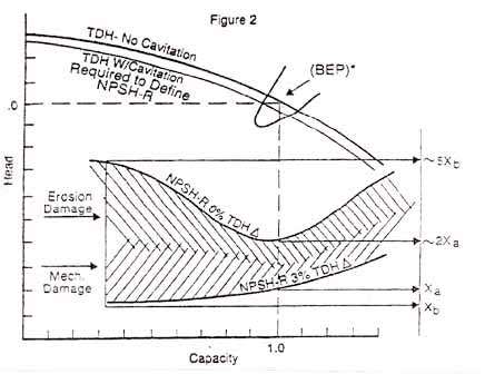

RE: Adding a VFD for the purpose of preventing cavitation and low suction pressure/NPSHA
Cavitation can occur above NPSHR, sometimes a lot more ( 3-10 ft).
For centrifugal pumps this sort of curve isn't uncommon.
I have never seen a curve like that, thanks.
