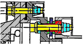

Please note that the stripper bolts no 4 in coupling drawing which attach transmission unit to hubs are also torqued to 10 NM. Why these bolts are not loosened due to torsional vibrations ?

while I am familiar with this type of coupling, I am having a hard time visulizing...BUT
just a comment, Is it possible the coupling is being installed using the disc pack bolts to provide some freedom? and thus the disc are being flexed prior to full bolt tensioning.

RE: Repeated Shim Pack Coupling Failure
another rambling thought...
I shaded/colored the shim pack bolting trying to grasp its details.
that drawing implies the bolts are sleeved (red). Is it possible the sleeve's length was preventing full clamping of the pack?

Thanks for your thoughts and putting effort to grasp bolt details. Its difficult for me also as I never disassembled these. However I will attach some pictures showing details. I believe the sleeve length is not preventing clamping of disc pack because in pictures in Annex-I show embedding/grooving on mating surfaces(Guard ring and spacer)

Consider the possbility that the shear pins have reached their fatigue life limit in number of cycles in completely normal operation.
I.e., this 'failure' may be a simple end of life event, not related to prior shim pack failures.

Dear Coupling Guru and Mike
Thanks for your replies
Regarding the requirement for shear pins below is my point of view
Just note that this coupling has angular contact ball bearing in addition to these pins. As I mentioned it is written on motor name plate that "rotor is axially unlocked and motor operation in decoupled condition not allowed" I think this coupling is there so that in case motor unloaded operation/solo run is required in field, only these pins are to be removed and motor will operate uncoupled with motor rotor axially located by angular contact ball bearing inside. I am aware of the fact that all big motors with sleeve bearings do not have thrust bearing and rotor is located axially during normal operation by magnetic force and during startup shutdown by small collars on rotor which bear against white metal lined faces on one of bearings. I think this motor may b missing any of these provisions
I tend to agree with the point that this pin failure can simply be end of life failure. Although I have seen shim pack couplings operating for more than 20 years on steam turbine driven compressor trains but none of them had these pins. May be because of slight clearance between pins and pin holes highlighted by coupling guru these may have limited service life.
Just one questions can these pins cause torsional oscillations which may have contributed in failure of the last coupling in the train having least service factor among the three couplings ?

Quote (fsx)
... can these pins cause torsional oscillations which may have contributed in failure of the last coupling in the train having least service factor among the three couplings ?
I can't answer that question.
But given the normaL operating speed, even tiny clearances can potentially affect the kinetics of the entire train, so whoever is doing the dynamic analyses should at least make an effort to account for such things.
Mike Halloran
Pembroke Pines, FL, USA
Mike is spot on
It is hard to say what the problem is, but it is easy to theorize what could happen. If those pins are not actually shear pins and are meant to be easily removed to run the motor de-coupled then I would definitely think that there is some clearance there. That is hard to model in a torsional performance curve. That unknown could have you operating on a harmonic. That harmonic could have caused the bolts to fail on the other side. Now over-sizing that coupling could just put more stress on those pins, but this is all speculation. The only way to completely put it to rest, would be to test the couplings torsional stiffness and then re-run the TVA with the actual torsional stiffness of the coupling, not a calculated value.
