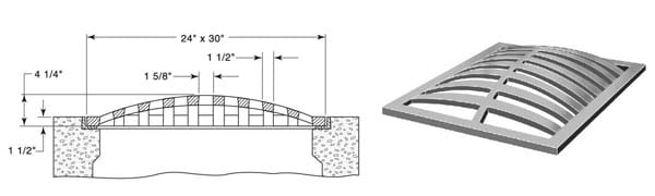

Earlier this week I was talking to a industrial client who showed me some storm water boxes (on site) that had the grating on them permanently bent. (Fortunately, I had nothing to do with the design of these things.....but he wanted to complain to me nonetheless.) He was looking for a explanation.....and I really didn’t have one. In my experience, the people who fab these things do it based on a ASSHTO wheel load. (Just about the worst case for a highway if memory serves.) But you look around just about any road (and I've looked since then) and just about all of 'em are bent.
So does anyone know why this is? Is it because these grates are seeing a excessive load? Perhaps loaded by a smaller area than anticipated? The repetitive nature of the load?

I'd bet money they're in upside down. They're supposed to crown up to keep debris from clogging the drain. I've only ever seen grating fracture, never yield.

According to the client: no. (I thought of that myself.) The dip seems excessive for that purpose anyway. (Compared to new ones I've seen.) It's creating quite a bumpy ride for the plant entrance road.

By grating I'm assuming we're talking about cast grating right? Not bar grating.
The convex grating can have a fairly large curve:

Thanks....but the situation I observed was so unsymmetrical (in its deflection), I doubt it was cast like that.
RE: Bending of storm water box grating
Well, if it's permanently deflecting that much but not fracturing then it must be ductile iron. An H20 load rating is the AASHTO load rating you're looking for. This is a 16,000 lb wheel load spread over a 10 inch x 20 inch contact area. Grating rated for this should have sufficient capacity for pretty much any vehicle load and should not be permanently deforming under short or long-term loading.
About the only thing I can think is you have non-traffic (pedestrian) or medium duty grating in there.

That's something I hadn't considered.......need to measure it the next time I'm out there.
Also need to consider crane or forklift traffic. I doubt either could exceed the AASHTO loads....but I've caught these guys moving some crazy loads before.

It seems as if you're transposing between heavy duty grating and cast iron storm grates pretty freely. Heavy duty grating is used for drainage grates. It's sized based on loads and spans. For some examples see http://www.dfwgrating.com/wp-content/uploads/2016/.... They're basically just standard grating with depth, spacing and bars sizes made to carry either truck, cars or forklifts.
Cast iron storm grates are manufactured by companies such as Neenah. Their products look like the examples above and since you didn't disagree with those, I'm guessing that's what you have. I've never seen these deform, but there's a first time for everything. I'm sure they'd be interested in any bad experiences. They have engineering departments that could get to the bottom of it. I'm sure a couple of pictures and/or dimensions would allow them to tell you real quick what is wrong.
Unless these were some kind of counterfeit grates (very possible), they're most likely the wrong grate for the application.
