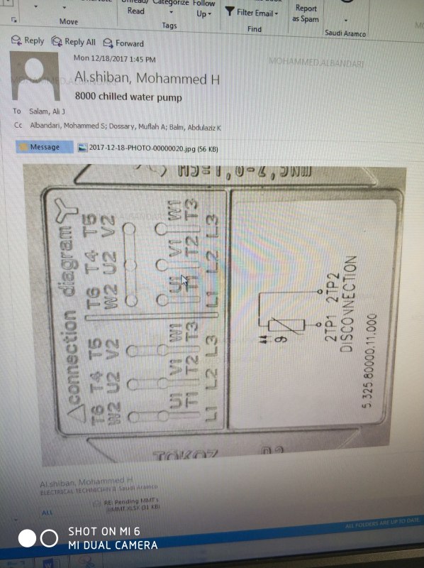

Hi everyone,
If any one can help with the right method to change a pump motor from 460v to 220v. I will attach the connection plan of the motor.
I wish that you can help me with this urgent issue.
Thanks.
RE: Changing a motor voltage from 460 to 220
You can't.
You can obtain a 1.73:1 voltage change by going from star to delta wound, so a 460V star-connected machine could operate equally well on 266V if connected in delta, or a 460V delta-connected machine could operate equally well on 796V if connected in star.

A connection that I have used and seen used many times is the auto transformer boost or buck.
In this case a boost.
If you can source a pair of 230:36 Volt transformers yu can boost your 230 Volts up to 266 Volts.
The current rating of the 36 Volt winding must be equal to or greater than the rated current of the motor.
What does the motor nameplate actually say and what do you really have as far as your supply frequency? Because that is most likely a 400/230V 50Hz motor that COULD have been used at 460V 60Hz connected in Star. If so, then as a 400/230V 50Hz motor, you can connect it in Delta and run it at 230V 50Hz just fine.
Don't worry about the 220/230V issues, those are just nominal values, motor typically are designed for +-10% to accommodate those variances.

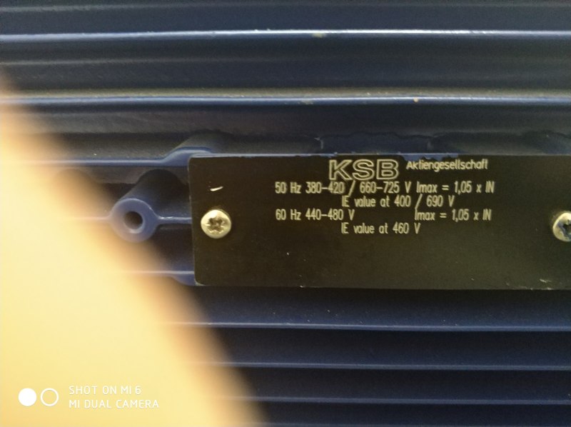

Good day all,
First, I would like to thank all of you for your responses. I will attach the name plate so you may advise me if I can give it a try to turn it on 220v.
Thank you.
It's a 400/690V connection. The motor cannot take the rated load at 220V without rewinding.
In terms of cost, installation, maintenance, foot print and modes of failure,
Rewind>New motor>New Transformer.
