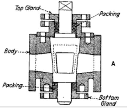

Dear all,
I need your help. I have googled for hours but cannot find this type of valve: "double gland" type. Probably it is known by different name, but if anyone knows how does this valve look like, please help.
Thanks very much
Aida

Could this be a translation problem from "Twin-Seal", which is a Cameron brand?

is it used for the blow-off cock similar to a plug type of valve?
per name of "double gland", I guess that there are two glands for two valve packings design.

I doubt it, although I am not native born English speaking. 'Twin' is in technical language usually used for two separate items in series, or two items doing the same thing. Not as here doing two separate things, sealing two different openings.

I thought that's the one, but maybe there's other design that fits the criteria of double gland.

Thanks for your input. Yes, probably the sealing is in series, meaning if one gland leaks, the valve still has the other seal, you know, like that below valves. Have you any picture of this valve? I googled and cannot find one.
