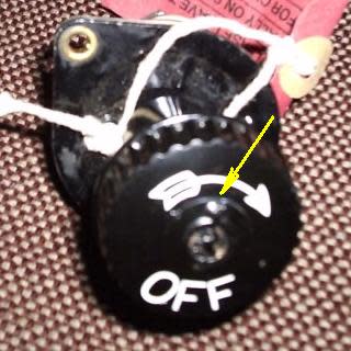

I installed a battery cutoff several decades ago. thus I don't recall how it did it.
I now want to remove it but can't figure out how.
I just noticed a slight raised center section, that might have been a press in cover with a screw holding the knob to the shaft.
the question is, any suggestions on how to pull that center piece (hoping it is removable)
OR
If anyone is familair with a Lucas SBB103 switch, how does the knob come off

Is there a setscrew binding the knob to the shaft? My Austin Healey has a shutoff switch in the trunk(boot) but I never took the switch out or apart.

there is no radial screw access either on the black plastic shaft nor knob outer diameter. even the metal drive shaft for the mechanism is full round with no "keying" ridge/flat.
In my gut memory, I recall thinking this will never come off again when I installed it.
while I want it out (It was erractic during the recent getting the car driveable again work), I don't want to mangle it up.
I am planning on hot gluing a bar on that center emblem and MAYBE it will pull off and expose an axial holding screw.

Can't get a pick or something under it?
RE: battery cutoff switch removal
my attempts to get a micro flat blade screw driver have only made gouges. I really don't see any division line, it is just a hope as a possible means for the knob to be retained.

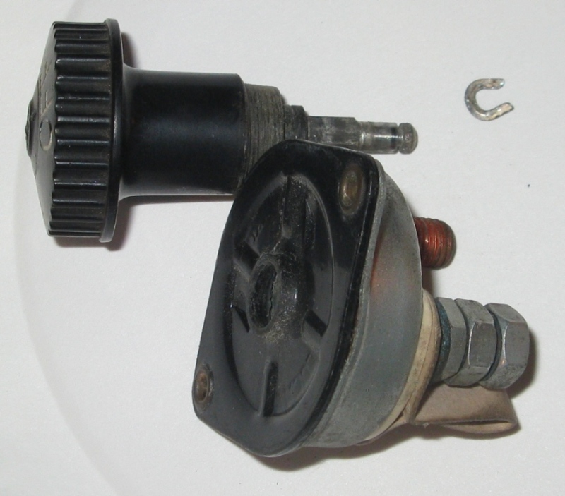

My recollection from working on the odd classic car is that the knob is a push-fit onto the shaft. I can't remember if it is a D or spline. The visible portion is cylindrical, but the hidden portion isn't. If you glued it years ago then expect it to shatter if you apply force. If you didn't glue it then expect it to shatter anyway. Such is life with old British cars.

other discriptions of the current offering Berkshire linked, refer to it as a "permanent" knob and the mounting instructions are for a larger hole to hide the mechanism and the flange (and knob) be external

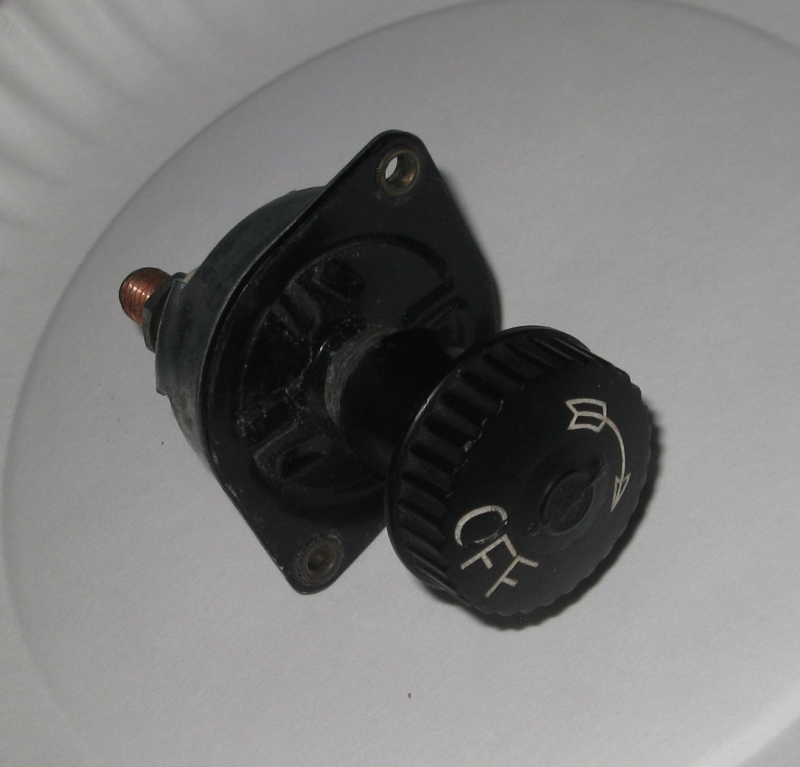

Ten penny I think the picture byrdj posted is of the removed unit.
B.E.
correct...
My mechanical aptitude has declined a lot in the last few years.
It finally dawned on me, if I couldn’t remove the knob from the switch, then remove the switch from the knob!
