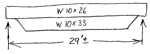

I am looking for some input from those with more experience. I seldom do much engineering with steel. I have a client who wants to remove a column in the basement of a single family dwelling. The existing beam is a W10x26. The full span is approximately 29 feet with concrete foundation walls supporting both ends. A steel column is located near the mid-span. So with the column removed the span would be doubled. Obviously the existing beam is very undersized for this condition. I discussed other options such as new columns or walls closer to the ends, but this is not acceptable.
I am looking at typical methods of strengthening the beam. Based upon preliminary engineering I was looking at welding an HSS7x4x1/2 to the bottom flange (7 being the width). I have a bit of headroom to play with, so a deeper option may be used. This gives a deflection at full DL and LL of about 1 inch. I realize that most of the time (if not all of the time) the actual LL will be less. I am a bit nervous about this much deflection because of possible effects at doorways, walls, and tile shower. I have looked at the predicted deflection at the various areas. At some areas is is not bad, but at others I have concerns. My most significant concern is that the wood 4x2 trusses at one side of the beam have two different spans with the change in span occurring near the mid-span of the beam. This will create a significant difference in deflection between two adjacent trusses.
My other concern regards whether there are practical limitations to strengthening a beam (structural or serviceability). Any input on where to terminate the new member would also be helpful (other than where is is not needed from a moment or shear? standpoint). I assume spaced and staggered welding is advisable, but should there be continuous welding at some length at each end? Also, welding across the end? Any other special considerations for HSS?
Is this something that should work or or am I asking the reinforcing to do too much? New beam may be an option, but may not be practical or cost effective.

An HSS7x4x1/2 weighs 31.8 lb/ft and provides a composite beam with a combined depth 14". Span to Depth Ratio is 25:1 (348" / 14")
For essentially the same weight, an added W10x33 (Flange width = 8". Web & Flange thickness comparable to existing W10x26) will have significant advantages over the HSS7x4:
1. Total depth is 20", Span to Depth Ratio = 17:1. Less defection and greater stiffness (higher Moment of Inertia).
2. I have not run the numbers, but almost certainly a higher section modulus. Lower bending stress.
3. The welds are located closer to the composite beam's neutral axis. Less stress on the welds.
I would cut the ends of the added W10x33 at a 45 degree angle:
If an added 10" depth is too much... perhaps a W8x28 or even a W6x25 instead.

I'd look at paralleling two beams alongside the existing. It may take cutting new beam pockets at the ends or columns against the walls. Have fun getting them in. Another alternative is making a king post truss with a tie rod under the old beam. or maybe that on all three of the first sentence here.
RE: Limitations to strengthening a steel I-beam
I have several concerns with the proposal to reinforce the beam
1) as stated above, the end connections are now carrying much more load than previously designed for - Do you have clear understanding of the capacity of the wall connections? In concrete walls? (doubt it)
2) There was a period of time when we reinforced beams with a "beam under beam" approach. Further analysis revealed that the dramatic lowering of centroid caused the upper beam top flange to fail - this assumes a laterally Unbraced span - you did not mention if braced or not
3) if you get past braced and end connection concerns... Agreed on stitch welding another beam under. And add 20" or so continuous weld at ends
4) are you going to be able to get the 29' beam "into the basement"
5) the 10 x 33 is nice from the welder's perspective - 8" flange compared to the 26's 5-3/4" flange - means welds are in flat position -
