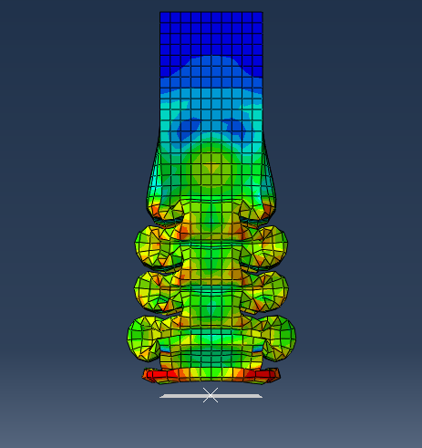

I have already tried general contact but it produced unfavourable results. I think the interactions are not processed correctly if I use that option:
I'm expecting an axial crush but instead I get something like this:
RE: Surface interactions inside another surface
Why do you think that this caused by General Contact?
Well I thought that because the structure should not move like that so it seems like a contact issue. I've varied contact stiffness in this mode a lot and couldn't really get much better. When I did get something better (where a crush happened and no weird movement) the crush stops halfway.
So in that general contact mode, either I get the weirdness above or I get something that barely crushes and then rebounds.
Do you have any suggestions?
This has nothing to do with the self contact. Run it without it and you will will get similiar results until the point where the part comes in contact with itself.
I don't know what kind of results you expect. When you think that it collapses without a major lateral deflection, then I have my doubt if the structure isn't too slender for that.
You can try to use imperfections. Do a buckling analysis first and reuse the modes to seed imperfections into your structure. This usually produces much more realistic results in a postbuckling analysis. Look for *Imperfection in the Keyword Reference Manual and also read the chapters that are linked to that. There is also an example in the Example Problems Manual.
