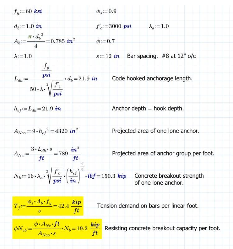

So, enough with the back story. What should one do? That part's harder. To my knowledge, there is no definitive method for assessing the breakout potential of embedded rebar. Which, when you think about it, seems utterly ridiculous given that it's surely the worlds most common anchorage problem.

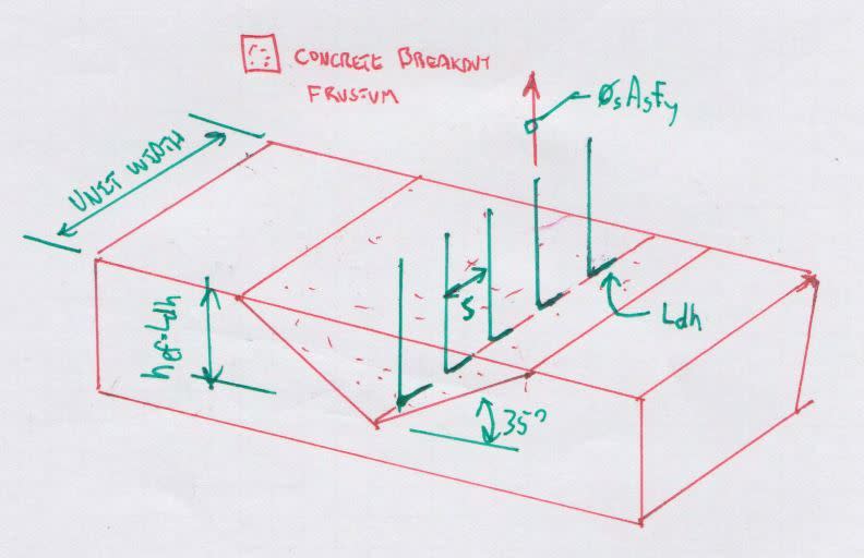

In the course of a previous debate here, I created a mathcad sheet to evaluate a single bar being pulled out of a mass of concrete with no edge distance or spacing issues. I played around with treating it like an App D hooked bolt, a headed anchor, and a post installed straight anchor. At least I think that's what I did. It's been a few years. My conclusion was that you'll pretty much always yield a developed single bar prior initiating concrete breakout in this situation.
However, I believe that you can induce breakout prior to yield when you're dealing with tightly spaced groups of bars. And that makes nothing but sense. Lots more force delivered to an only marginally improved breakout frustum. This concern will be an issue wherever bars are tightly spaced. Shear wall zones are a good example. A densely reinforced pier with moment might be another.

I was able to track down the result of my MathCAD work from this thread: Link. That was a mightily long thread so I'll save you some effort by just reproducing it here. It was for a slightly different situation: retaining wall bars "achored" rather than being designed/detailed as RC concrete. For what it's worth, it's not a practice that I endorse.

Based on your sketch, your compression force will land on top of your breakout cone. That helps although not as much as one might expect. The source European docs for App D provide a method for accounting for that. I'm not sure if it's made it's way into 318 yet.
