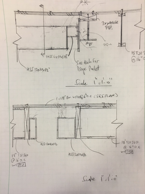

Hi ,
I am designing a connection for HSS and I beam. Since I am new in my career I am not sure what I should check for my calcs.
I was planning to weld 1/2" plate to the flanges of W 8x40 and connect another 1/2" plate with 4 bolts.
And weld the HSS 12x10x1/2" to the second plate which is going to be bolted to the first one.
My idea is to bear the I beam on HSS.
I would be glad, if I can get any input about this connection.
Thank you,

I'd recommend posting a sketch of your detail/situation. That will allow us to help you more effectively. I'm having a hard time visualizing your condition.
- this is definitely a beam-beam connection not a beam-column connection?
Quote (OP)
- So the HSS beam is carrying the I beam? Does it bear on top of it? This makes it sound that way but the description you provided of your proposed detail makes it sound like a side connection.

@KootK
Here is a sketch. There is a 9 kips of uplift on the I beam.
I need a little guidance about what I should check to engineer this connection.
Thank you so much!
