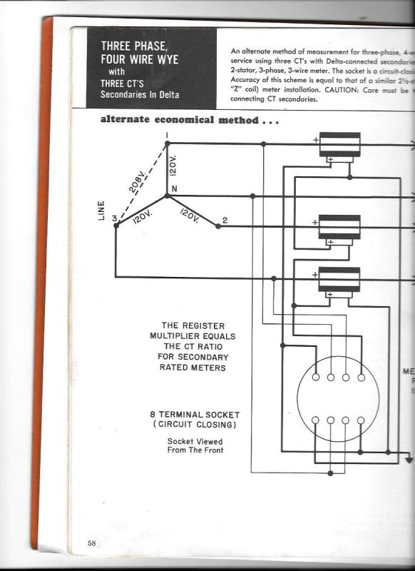

Hello All, One of our high voltage combined instrument transformers has failed and has to be replaced. I am trying to figure out a way where the secondaries of the remaining two CIT's could be used to create voltage and current for the missing unit for a balanced 3 phase power system.

If you are stuck with line to neutral PTs there is another scheme that uses two elements but three CTs.
You may be able to drop a bushing CT over a transformer bushing to meter the third phase current.
I can post the connection diagram if you need it. (The first time that I used this connection was the time that I used the single phase check meter.)

RE: Combined Instrument Transformer Failure on 1 Phase
That may be resolved by reversing the connections to the third meter element, but the bigger problem is that there will be no voltage for the potential coil associated with the third current element.
I the CT part of the metering transformer is still functional, or if you can get a large enough window transformer to drop over a bushing here is a circuit that will work.
I have used this connection a number of times.
The accuracy is as good as the voltage balance.
If the PTs are connected to A phase and C phase, then the B phase CT forces the current through both A phase and C phase current elements.
The A phase element meters the A phase component of B phase and the C phase element meters the C phase component of B phase.
This will meter unbalanced currents to the accuracy of the voltage balance.
Bill,
We don't have spare CT available, nor do we plan on changing any phase to ground connections to phase to phase. Do you know why I am getting A and B phases to be 180 out?
The current is in the reverse direction going through the third current element.
The lack of a voltage for the third element is a problem.
You are familiar with the open delta connection to derive a third phase from two phases and a neutral.
There is a connection called a Winnipeg connection that will develop a third phase for a wye system.
The Winnipeg connection was used for distribution systems.
For metering you could use two small lighting transformers.
I would use 240:480/120:240 volt transformers wired for 240 Primary and 240 volt secondaries.
You will be applying 120 Volts to the 240 Volt windings.
Connect one transformer in parallel with the secondary of each PT.
Connect the secondaries in open delta. The voltage developed across the open delta will be the correct angle to replace the missing phase.
I suggest checking the primary and secondary voltages with a good meter to determine if there is a turns ratio error.
What type of loads do you have?
For most plants that I have seen, the phase current balance is good enough to use a 3/2 ratio.
If you have a lot of single phase loads that tend to be unbalanced, this may be better than nothing.
