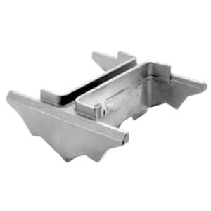

Instead of a pile shoe, perhaps a driven precast concrete pile with a composite H-pile, including an H-pile point:
Then the pile installation is "routine" pile driving.

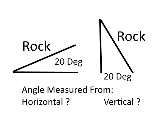

Is the 16-20 degree slope measured from horizontal or vertical? The above suggestion should work for horizontal angle... not for vertical angle.

SRE - thats what i was getting at too, i would think that the could be driven down to rock with a slope angle of 20degrees from horizontal.
They would not get the socket into rock as a drilled pile would but do the loads require a rock socket. Rock socket is definitely good practice/norm but might not be essential.

I like SlideRulEra's solution. An alternative might be either steel H piles or steel pipe with special points such as those marketed by Associated Pile and Fitting Co. They have a "Rock Injector Point" for H piles intended to penetrate the rock and hollow cylindrical points for pipe piles that would allow drilling a rock socket below the pipe if necessary. One advantage to pipe piles is you can look down them and see whether they are curving off to follow the rock surface.
