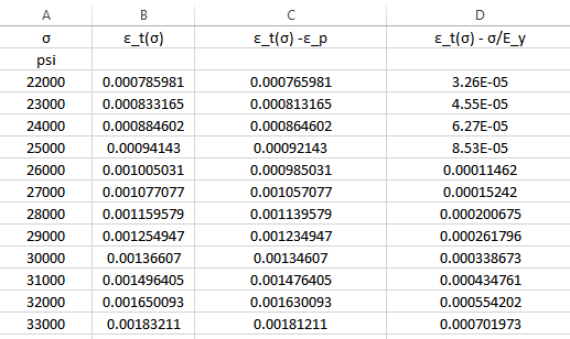

Would anyone be willing to post your elastic-plastic stress-strain data points (per Annex 3-D) for a material such as SA-516 so that I can compare it to my MathCAD results?

Sure. What temp? What are you using as your proportional limit?
RE: VIII-2 elastic-plastic sample stress strain data points for verification
Trevor, 100F would be fine. I'm using Ey=29.4E+06 psi.
Addendum: I'm using epsilon_ys=0.002 and epsilon_p=2.0e-5

My calculation of the proportional limit is based on when the calculated plastic strain is greater than epsilon_p. Note that the FE software that I use requires that the plastic strain at the proportional limit be set equal to zero - hence the zero plastic strain in the first row.
TGS4: I was able to get the same results as you; however, we calculated plastic strain in a different manner.
I expected plastic strain = ε_t(σ) - ε_p. Whereas, you calculated plastic strain = ε_t(σ) - σ/E_y.
My version keeps the elastic strain constant (equal to ε_p); however your elastic strain continues past the proportional limit (as σ/E_y).
Is this a result of how your FE software expects the data; or am I misinterpreting something?
I've attached a screenshot of my data. Row "C" is my interpretation of the plastic strain; and row "D" is how I reverse engineered your interpretation (equal to your dataset posted previously).
thanks,
Dave
Total strain is equal to the elastic strain plus the plastic strain. The elastic strain is σ/E. That is true regardless of whether you are above or below the proportional limit - there is always elastic strain. ε_p defines the proportional limit (which is different for different materials).
I'm not sure how you made your interpretation from Annex 3-D? Your interpretation is incorrect. Refer to equation 3-D.1. gamma_1 + gamma_2 IS the plastic strain, which when added to the elastic strain, gives you the total strain.

Trevor: thanks again for all the info. I don't know how you find the time. Do you ever sleep? As your were writing your last post, I re-read the definition of y_1 and y_2. They are of course, like you said, the plastic components of the total stain.
My incorrect interpretation was formed based on how I believed material behaves beyond the proportional limit. I did not think that additional elastic strain (equal to sigma/E) would form in the plastic region. I was under the assumption that elastic strain's upper bound was equal to the strain at the proportional limit.
